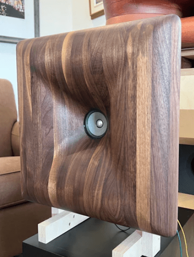

I have a set of TB 3” ‘full ranges‘ in little boxes with practically no front baffle. They sound great except of course the limited bass. That got me wondering if we aren’t chasing shadows and not roping any dogies. My son has the same driver mated to a 7” Dayton aluminum cone woofer and that sounds great in his small apartment, so you might be on the right track with a near field WAW.
The side firing woofer would allow you to use the narrow side of the box for the front full range. The crossover would be low allowing the woofer to be placed at some distance around the side. Then you could make a large maybe 4” radius corner from the front to the outside face. The front would match the edge of the monitor and the inside face would match the monitor edge. With this configuration you could use a pretty big woofer like an 8” subwoofer and cover the full range.
