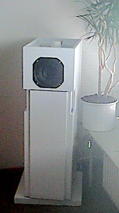

nige838

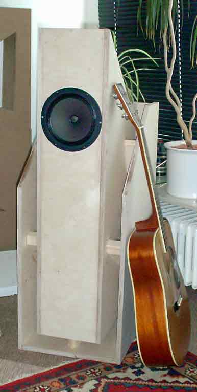

Hello,
very cheap,
but the lack of highs would it not prefer as a
single driver, but i simulate the driver in my
double horns SAXOPHON and RDH20 and it will work
as an second invers indirect driver, like Visaton Bg20
and SPH-210 Monacor.
~97 dB 34 Hz extrem good IMP for an amp with 1,5 W
enough.

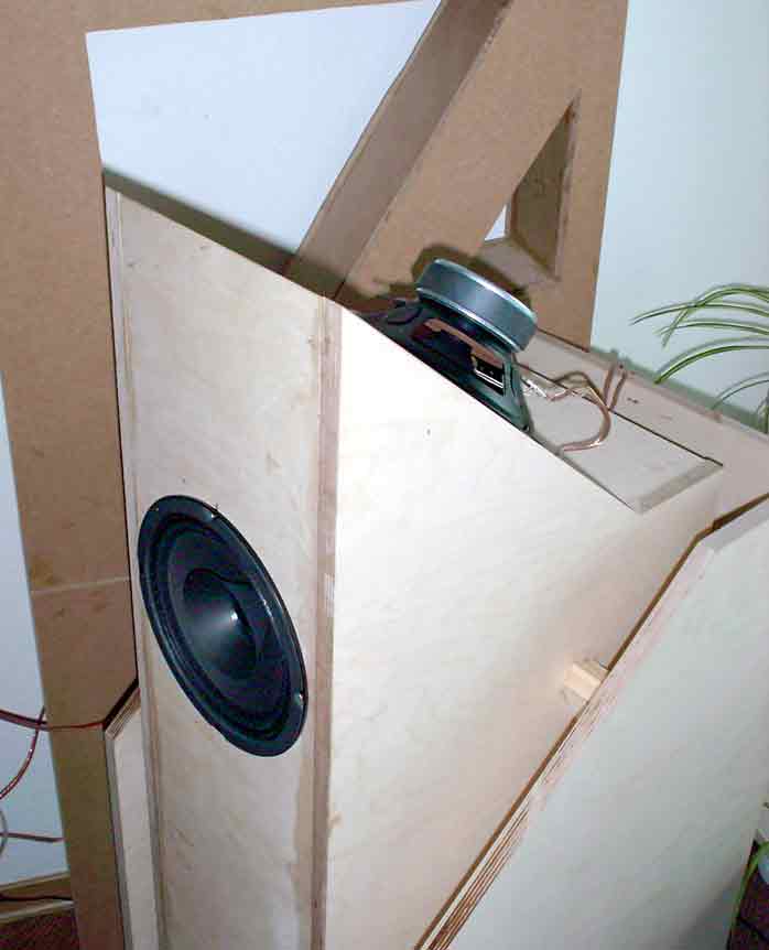

I suggest putting the driver on the bottom of the box ,obviously tilted .
Curvy box (at lest from the outside ) with large baffle ,since the power is ...😱....the box may be thin and rigid . The more the horn expansion from throat to mouth transforms air velocity and vibration in air pressure radiation,
the least the material (of the mouth)has to face those forces but somehow has only the duty to direct the sound , so a braced thin plexy sheet would suffice .
