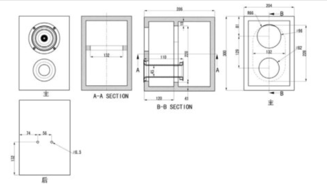

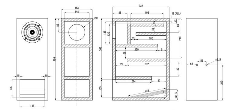

I'm looking at cabinet suggestions on the TB web site and they seem to have both back horn type (well, it looks like a rat maze) and ported speakers that are under 2'. Am I correct to say I should just stick to ported if under 2'. I'm also open to DBR design - simple provides greater incentive.
That 1st looks like a horn, but is too small so it ends up as a poorly designed quarter-wave resonator.
