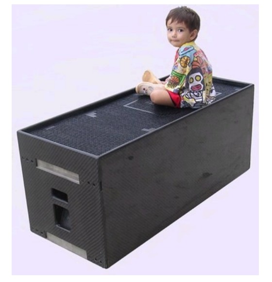

Let me see if I understand your question.
It's your idea to make similar speakers knowing the external size of the speaker enclosure and you want a bass reflex system with 3x15" drivers, or I'm missing something?!
emPad B315 Low Frequency Speaker System
Low frequency transducers 3x15" Drivers
Low frequency cabinet operating dimensions in mm 1090Hx490Wx500D
B315 | emPad Professional Concert Loudspeaker Systems

The spec sheet is pure fiction, it violates the laws of physics.

Thanks for the spec, but I want to know the construction inside of box? Is there between 3 speakers skating or not? Then whats size of vent and where it position?The spec sheet is pure fiction, it violates the laws of physics.

In what part, I didn't noticed?"The spec sheet is pure fiction, it violates the laws of physics.
"In what part, I didn't noticed?"
The combination of size, efficiency, and frequency response are not possible.
A 2 cu ft 2nd order sealed box with an F3 of 30hz can only be 0.18% efficient (84.55dB).
A 2 cu ft 4th order vented box with an F3 of 30hz can only be 0.36% efficient (87.56dB).
A 2 cu ft 6th order vented box with an F3 of 30hz can only be 0.90% efficient (91.54dB).
The efficiency of the 6th order is midband only, in the lowest 1/2 octave of the LF there is 6dB of boost applied (so it is not violation the laws of physics as it seems to do).

B 315 Low Frequency Speaker System
267.05 liters = 9.4308 cubic feet
A 2 cu ft ...
"are you sure we are in the same page??? "
You aren't.
Every time you double the box volume you can add 3dB.
Your 9.4308 is gross, the 2 cu ft spec is net. Even if the net on your box was 8 cu ft (and it isn't even that big) that would only add 6dB to the numbers for the 2 cu ft box.
91.54dB + +6dB = 97.54dB
108dB is pure fiction.

Maybe it is, I'm not saying it's not... bear with me!108dB is pure fiction.
(Having in mind I don't know what type of system/drivers they are using, do you?!)
1. Let's look at 18Sound 15NLW9500 (3x)
I'm using net vol. 245L = 8.65ft³
OB system (not the case):
2Pi SPL = 106.4 dB/2.83V/m
4Pi SPL = 102.4 dB/2.83V/m

Announced emPad B315 Specs:
System sensitivity @ 1m/1w = 108 dB
Maximum sound pressure level = 138 dB
The difference for this driver system sensitivity vs. the emPad is accentuated but the max SPL is not.
I can only say that specs where taken with another driver/system or at a high frequency, from my point of view, were output peaks.

I don't know of any brand of drivers that can violate the laws of physics, do you?
Paralleling three drivers with 2.83V is not 1W either, it's 3W (+4.77dB). Even giving you that cheat it's still not 108dB.
