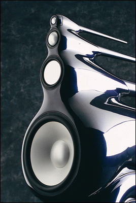

I love the Nautilus... I get that it's dated now and kind of goofy on some levels... But it's just a cool speaker... I have no idea what they sound like though...
I've always wondered if there was a way to do a cheap, excellent sounding DIY version sort of as a thumb to the nose to the $30K a speaker set.
But there's no sense trying to do an exact copy of them. I would have loved to see them leave the top 2 enclosures in a deep wood finish, the bottom shell in a pearlescent white and then texturize the concrete with beech sand with maybe a few 'fossils' thrown in for good measure.
They're a visual-impact heavy speaker... I say take that and run with it...

I've had several chances to listen to the Nautilus. It can be very good indeed, if used properly. 4-ch active xover, so you need 8-ch of amps to drive a pair. I've seen 8 mono Aleph amps serving a pair of Nautilus and that was the best case I've heard. (but not the best speaker system I've heard)
For clone, I don't think so If I had that kind of building capibility, I'd do something else.

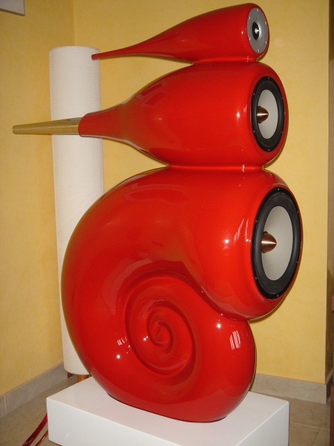

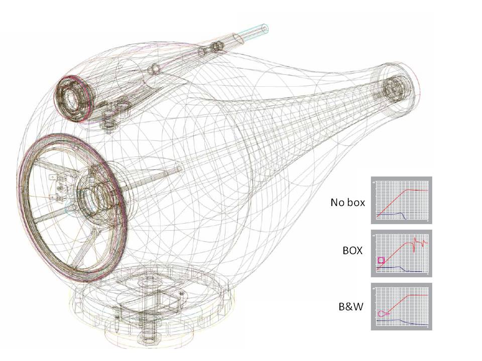

Attached pictures: The RED B&W Nautilus clone described in the weblink has a non-optimal long spacing between the midrange and tweeter. Both the BLACK production B&W Nautilus and the B&W 801 model top have a much shorter midrange-tweeter spacing which should provide better crossover integration.
I am a believer in the B&W engineering behind the sphere+tapered tube structure for the mid-tweet. A tweeter like the SB28RDCN-C004 has an NdFeB motor which makes it small and efficient for a close M-T spacing. For the bass, I suspect an extensively braced, thick wall cabinet with rounded corners could provide better sound than the Nautilus clone construction.

I was a bit disapointed he went to all that effort to turn them then just went and sprayed them grey, I couldnt believe that
Also under the impression the B&W on the inside looks nothing like the outside, so copying the external design isn't a guarenteed true copy....
