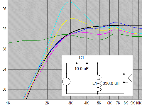

I have a plot of the difference here. A tweeter (green) has the crossover applied (blue) to be close to the target slope (black). This has been done using a full impedance plot.Could the effect be much more pronounced if simulated with real instead of idealized load?
Where the impedance magnitude (level) of the plot is correct but phase information is missing (zeroed in this case) the response will come out on the simulator as shown in pink. When pure resistance has been used, you'll get the yellow plot for 8Ω, cyan for 12.
It will not be possible to have confidence in a simulation to the level you seek unless you have impedance plus phase information, and of course acoustic (frequency response) plots for each driver. For the combined responses you'll also need acoustic phase (e.g. four plots per driver).
To re-engineer the crossover for improved performance I would take directivity plots seeking the power response of the drivers to augment the single plots.. and for finding the right angle to listen at.

Indeed you are right, my simulation shows that R2 + C5 combination has a very strong influence on woofer response. Surprising that B&W chose 10% tolerance parts to go in there.
I will certainly be tweaking these values. My choice of Evox MMK is probably overkill for this place, but most of all I want to be sure that what I set up today will keep its parameters for years.
I know this post is old, but if someone wants to chime in great. I have a pair of 802 S3's and have replaced all caps with films (not touching the inductors). I think they sound great, but after reading posts here (mainly from Glinda) they may be a little forward.Indeed you are right, my simulation shows that R2 + C5 combination has a very strong influence on woofer response. Surprising that B&W chose 10% tolerance parts to go in there.
I have been exercising Glinda's Xsim model and come to some conclusions, that may or may not be correct,
1) I do not see a need to compensate for ESR on any cap other than possibly the 26uF one as this does not change anything much at all. R2 and C5 seem to be best left alone.
2) The model seems to use a 5% DF in it. Has this been verified with the Bennic caps? I no longer have the originals and cannot check them.
3) I am tempted to put 0.5 to 0.6 ohms in series with the 26uF cap to soften the hump around 615 MHz. This would correspond to a DF of 10% if that is what the original electrolytic had.
