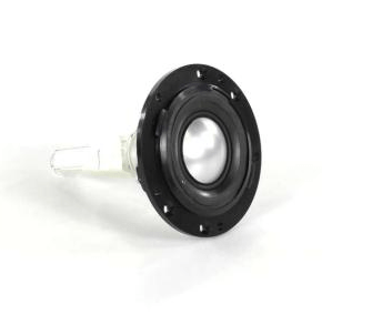

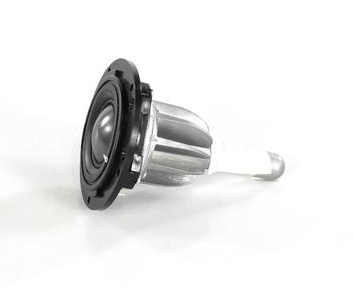

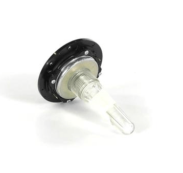

Thank you for responding. I only have the 606 S2, But also have the tweeters of 706 S2 and was wondering if I could swap them out to hear any difference or improvement in sound. I was just wondering if the 706 S2 tweeters require a different crossover.

The 70x S2 speakers use the HF01511 tweeter, which is a 1" aluminum dome with an integrated heatsink and tapered tube loading.
The 60x S2 tweeter is not the same model. It is the HF01716:
If you don't change the crossover, whether you think it is "better", or not, may due to sheer luck, or auditory preference.
If you swap the tweeters, you generally need to change the crossover.
