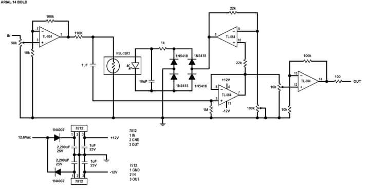

If you haven't found anything yet, this circuit will work quite well.
- Automatic Volume control for online TV
