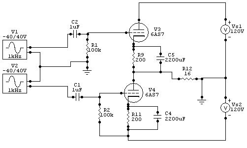

Something like this?

nice idea.
R16 (16R) represents the speaker load?
Best to look at This diagram, its much more like what Ive built--The speaker connections are clearly shown,--no chance of error......:)
http://www.audiodesignguide.com/my/OTL_version_82_cheap.gif
The above diagram posted by Semperfi doesnt have the right drive format, or the connection of the earthy end of phase-splitter to the speaker output connection--which makes a Futterman, a Futterman....:D
Yes indeed R12 (16ohm resistor) is the load. In this simulation using only one 6AS7 it is little interest in using a standard 8ohm load.
The 'drive format' is for simulation of the output stage only, although it can be done that way. And it's true I'd never do the Futterman way of doing it;D
