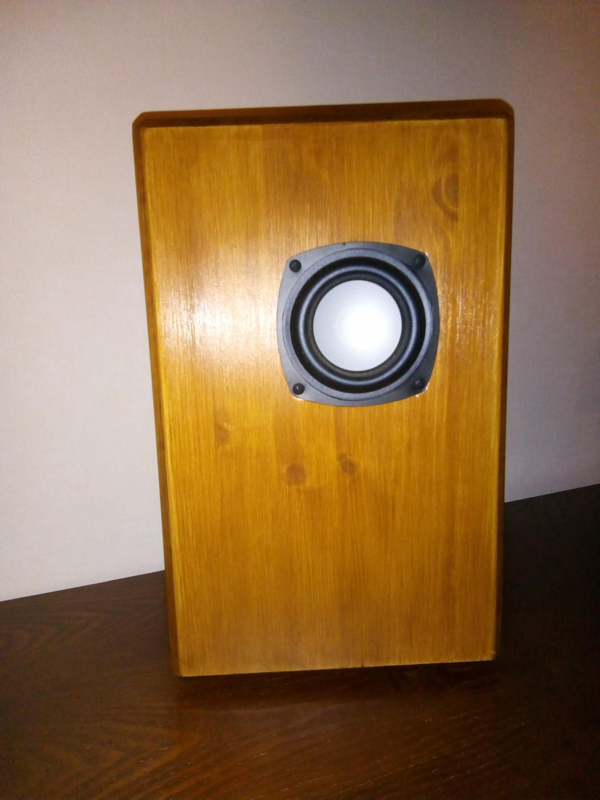

Thanks for the well done measurement. You did a great job in displaying and explaining the diagrams. I like the small 3" Inch woofer and have a pair running in planet10s minifrugalhorn and another in a simple 6l/60Hz BR. The only extra effort I spent in them is a parallel Zobel for impedance linearisation with the nice extra that they are playing much smoother in the highs and can be used in nearfield. Thank you for offering your data 🙂

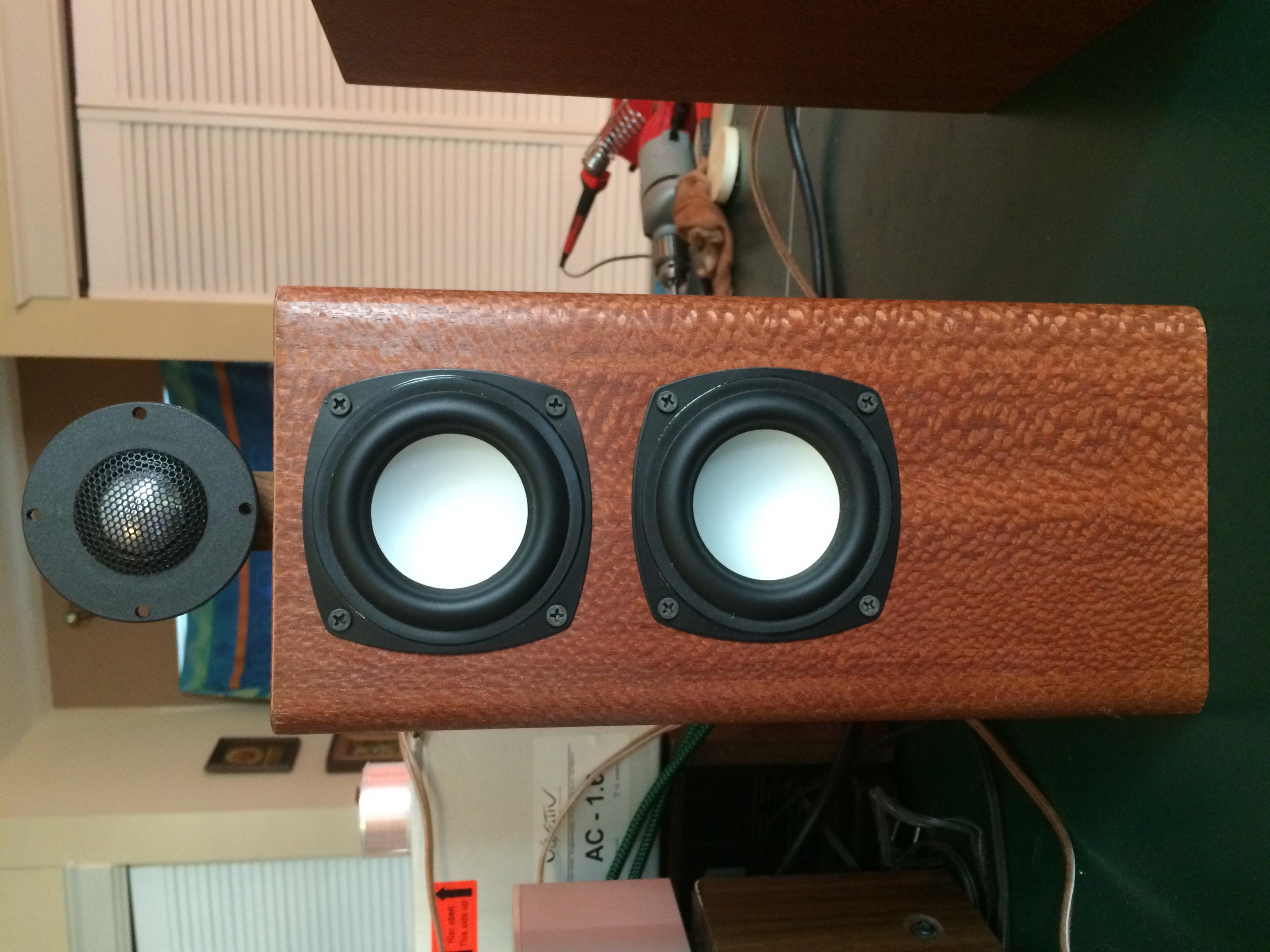

I like these little drivers for what they are and what they cost. I put two of them into a small sealed cab....while their low end is impressive for a driver this small I thought they were soft on the high end and added a cheap tweeter...I'll admit I liked the result.
