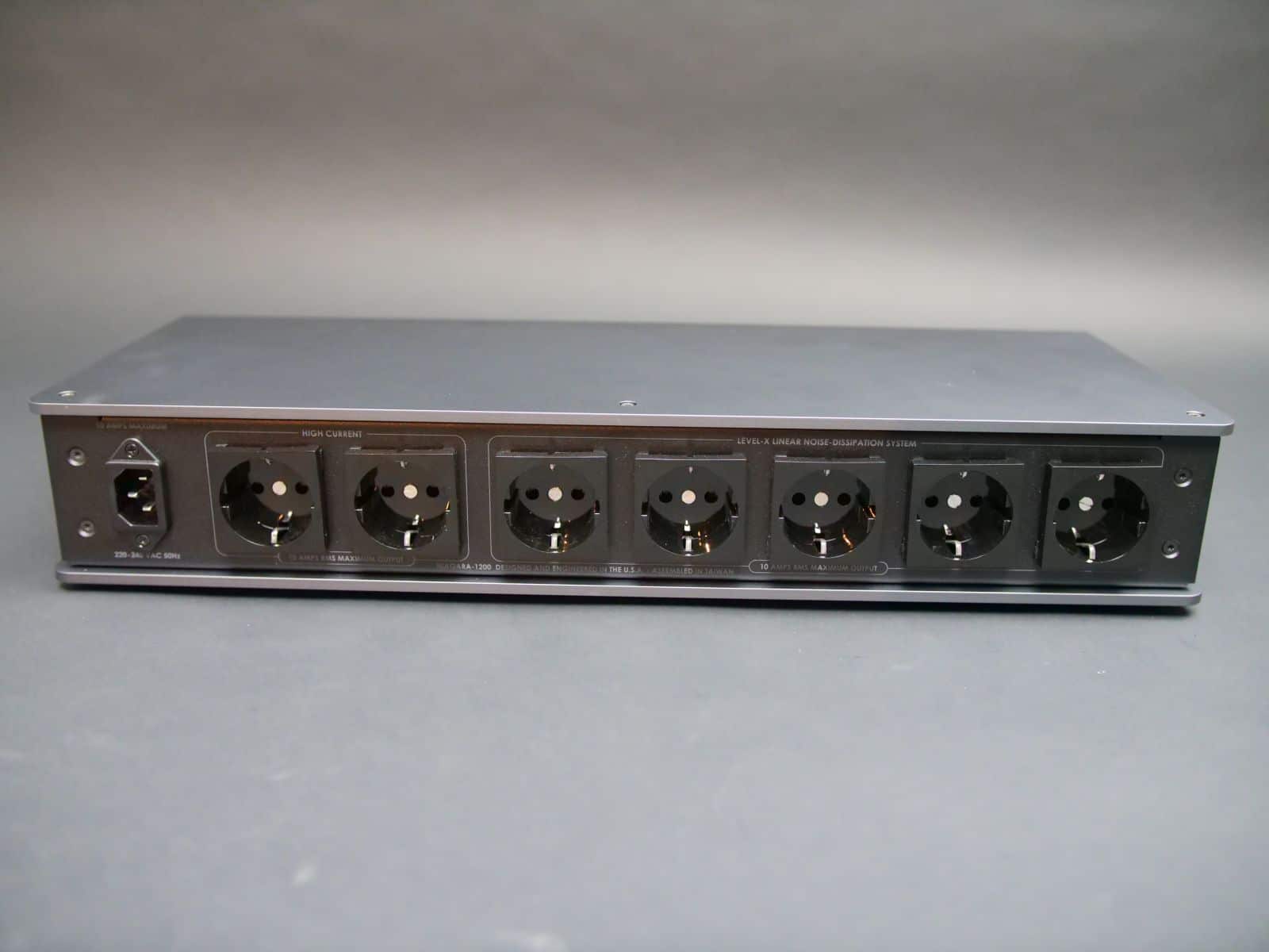

Hello everyone. I'm currently uncertain about whether I should invest in an Audioquest Niagara 1200 Noise-Dissipation System. I brought this unit home to test its impact and I believe I can perceive enhanced clarity, improved microdynamics, instrument separation and so on. However, I'm cautious about potential biases in my hearing and the influence of psychoacoustics in this situation.
I'm interested in hearing from anyone who has tried a similar setup with Pass Labs equipment. Considering the specifications and the inside parts of the Audioquest Niagara 1200, do you think it has the potential to negatively affect the music signal?
SPECIFICATIONS
  • Level-X Linear Noise-Dissipation Technology: More than 19 octaves of AC differential filtering (20kHz–1Ghz in excess of 24dB) with linear response, optimized for varying line and load impedance
  • Patented Ground-Noise Dissipation (All outlets): 2 banks of direction-controlled ground-noise dissipation
  • Non-Sacrificial Surge Protection: Withstands multiple AC surges and spikes up to 6000V/3000A without sustaining damage—sonically non-invasive
  • Maximum RMS Input Current: 15 Amps (RMS)
  • Outlets: Source (5); High-Current (2)
  • Dimensions: 19.4" W x 3.2 H" x 7.5" D
  • Weight: 18lbs. (US); 8.16kg.

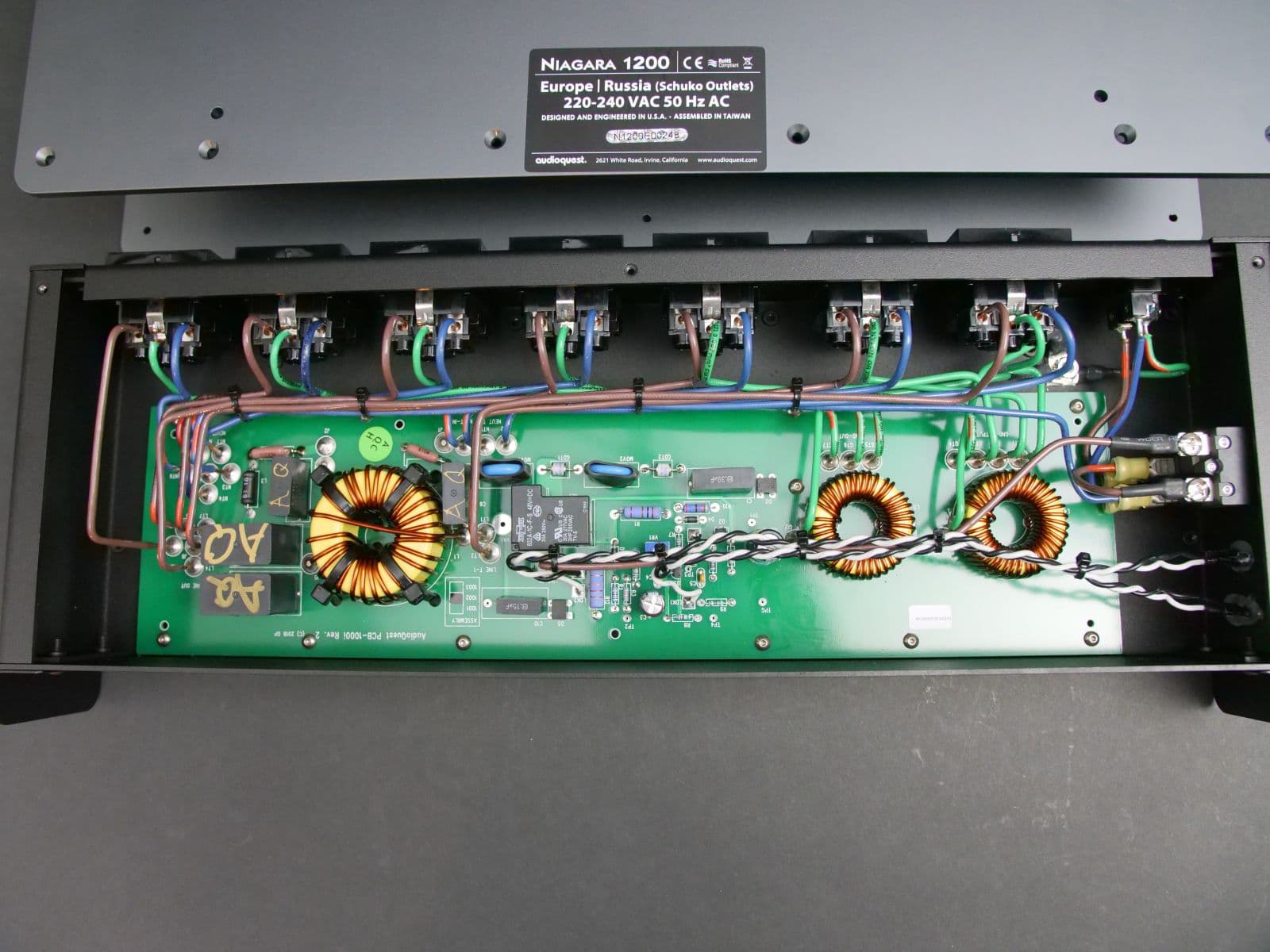

just an observation ....... strictly comparison-sake ....... INT25 having much more parts, but followed with much lesser BS from its publicity department
though, I'm common Peasant, what do I know about direction-controlled ground-noise dissipation
in short - I'm not expecting that doing anything more than mild mains filter in form of distribution box does
one word about level of workmanship - if that I see is is - solid core directly tighten with screw (Schuko sockets) ....... that's no-no; with time copper is creeping under pressure of screw tip, and we know what follows
solid core wire must have metal plate lip as direct pressure element, to avoid screw biting to small pressure area
I know I'm splittin' da hair here, but price of 1K Greenies demands hair splittin'
