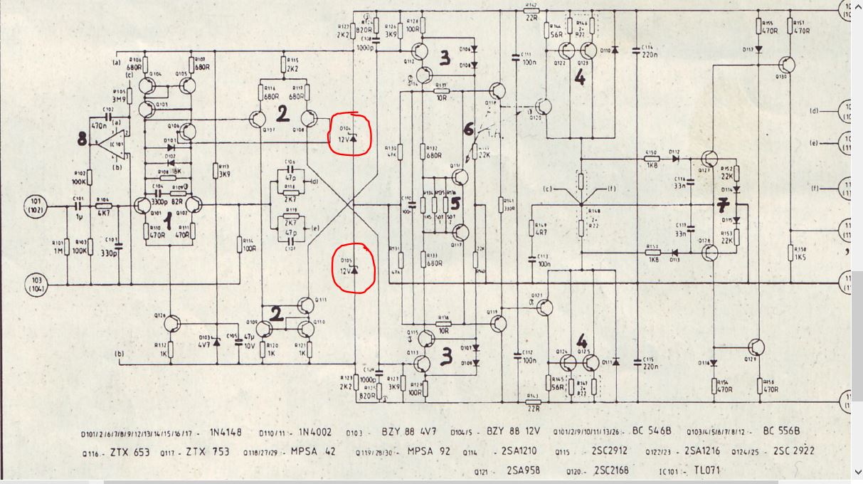

This does sound an unusual fault.
The diagram I have shows two 22 ohms resistors that carry the supply to the front end of the amplifier. Do you have the correct voltage on both sides of each resistor ?
There are also two 12 volt zener diodes in the front end supply. Each should have 12 volts across them.

Regarding the 22 ohm resistors at the front end; There is steady +58,9 volts DC on the side closest to the back panel, all the way to the output transistor leg, and -59 volts DC on the side closest to the front panel, also all the way to the transistor legs.
Located and measured nine diodes:
D104 and D210 (BXZ79 12 V) both 12,4 volts DC across.
Are these the ones you are referring to, Mooly?
D116 and D117 (1N4148): 0.01 volts DC
Two other 1N4148 had number unreadable as the text print crosses the tin-plated power supply: 0 volts DC across
Two other ones also had number unreadable as the text print crosses the tin-plated output, but on the component side of the print they are marked with 5501R: 0.05 volts DC across.
Bigger black diode D110 measured 58.9 volts DC across.
Any help in this?
Any help in this?
i would now measure the voltage across the emitter resistors it should be a few milivolts
