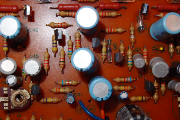

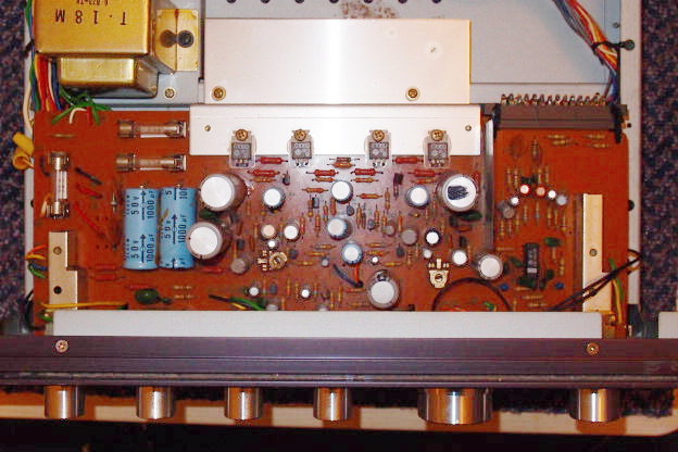

I have recapped an Audio Sonic ST-500 integrated (all the 35 electrolytics, 6 ceramic caps, the 4 rectifiers, and two VD1212-like diodes with 2x 1N4448 in series).
And the board during recapping:
The sound is amazing!!! I was wondering if it's a little Kenwood or Pioneer based amp as back panel has "Japan" printing, but internet sources says it's a Dutch brand from the Seventies (1975) and seems that it still operates today somehow.
Another source says it's from Glendale, California...
However, after the recap I still have (only on RIGHT channel) an annoying and PERMANENT noisy sound like a "hissssss" or "sssssssh" even when the volume pot is totally attenuated. When I'm listening to music in normal volume levels I can't hear the noise anymore because it's now overcome by the music sound. But in silent passages of the music or during radio interviews and news it is quite annoying.
I was thinking it could be a TR or a Zener diode or a high power resistor?
I'd need to know if the highlighted diodes below are Zener ones and if I can replace the with few I have in stock, rated 1,3W - 40V...
Or if you folks know or have an idea about this problem...
Thanks in advance!!

The pictures below were taken before recapping...

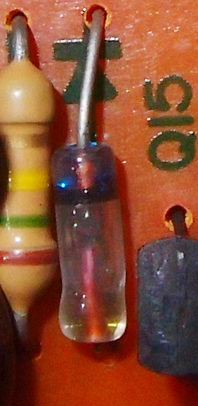

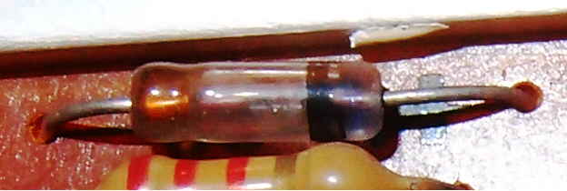

Hi folks,
Please, could you identify these diodes? (pics attached below, now enlarged samples)
There are three of them in the board I highlighted above.
I need to know if they are Zener ones or diodes for protection circuit.
My amp has a permanent "hiss" on right channel and I can't get rid of it!
Any help would be much appreciated!

These are germanium diodes but hard to tell what reference!Hi folks,

Diodes are indeed germanium types. They probably cause the noise/hiss. You could change them for 1N34A types but please measure U forward first. If it is around 0.3 V I would not hesitate to use BAT43 Schottky diodes that have 0.33 V Uf. Much more reliable, less leakage current and no noise. Please measure first as in that time sometimes diodes were used that were in fact a few diodes in series in one package. You can see that by checking Uf.

Yes, I identified the diodes and they are Germanium. I replaced them with AA119. The sound was a bit treble at first, but now it's getting stable and warmer. I replaced these Germaniums because they had different values (from .230 up to .415 second my DMM).
But they are not the source of the noise I have in the right channel. The culprit are the noisy 2SC458 transistors (6 of them are in the board) and I'll replace them with BC549 or BC550.

The zener was still good, but the Germanium were not. I replaced them with BAT86 (or BAT83 I think) along with the old and noisy 2SC458 with the newer and much quieter BC550.
The "hisssss" was gone!
