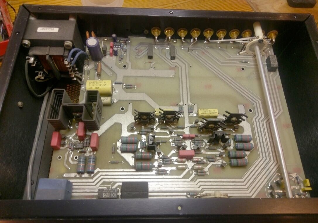

The tracks on the board are corroded and it has lived a rough life. At 30 years of age I was under the impression these things need overhauling. At least to do some preemptive work to reduce the likelihood of a catastrophic failure

" how hard would it be to overhaul the ARC LS3? I've been quoted silly prices. Can a newbie do it himself?"
I would suggest that the Audio Research Line Stage 3 preamp is definitely not for the beginner to overhaul.
That said if it is one of these-
it appears that there are only three electrolytic capacitors in the power supply that should probably be replaced, fairly straight forward,
IF you have good mechanics dismantling and reassembly skills, good soldering skills and methodical patience.
There are good film caps in there, they tend not to deteriorate and remain stable. Looks like a minimalist layout too, that's always good for audio.
I would check if there are functional errors present, If it ain't broke dont fix it!
Were it my machine to service:
The front panel would be removed sequentially, dismantled, servicing all potentiometers, switches replacing anything thats not functioning to specification. Cleaning the entire PCB and do careful track re-soldering.
Replacing all electrolytics caps, like for like or for e.g.: Panasoninc FM's/ FR's
Check/ replace regulators and any components that run hot by design, along with any semiconductors/ components that look heat stressed.
This is the part that you would need to find some one that is either capable of calibratiing the machine, as it is often whether or not you can obtain a service manual and whether or not it has the calibration settings procedure or if Audio Research will offer such data. Or find a specialist familiar with that type of pre amp, as all audio electronics have their own particular characteristics of degradation. A seasoned pro will know where to go and what to look for quickly, and thats what your paying for.
Do Audio Research still service their own legacy products? Find out, send it to them, get an equivalent Carnet to pass customs.

Thanks, I value the blunt feedback. Still curious why this 30 year solid state tech performs so well. Maybe it's the ARC touch
Yes, you might say that it's the ARC touch, but it's more correct to say that it's more thanks to ARC's knowledge and legacy in tubes.
LS3 have 270 Volt powersupply and are built pretty much as a single ended tube preamp but with J-fets and Mosfets.
Basically a transistor version of a tube preamp.
Low gain differential input stage with a single ended VAS and Mosfet buffer.
Very good engineering and single ended, non complementary VAS stages will have a very ear pleasing harmonic distortion characteristic where 2nd harmonic is slightly higher that 3rd. I say it's a very clever design that are highly dynamic and musical because of the high voltage power supply and single ended VAS.
