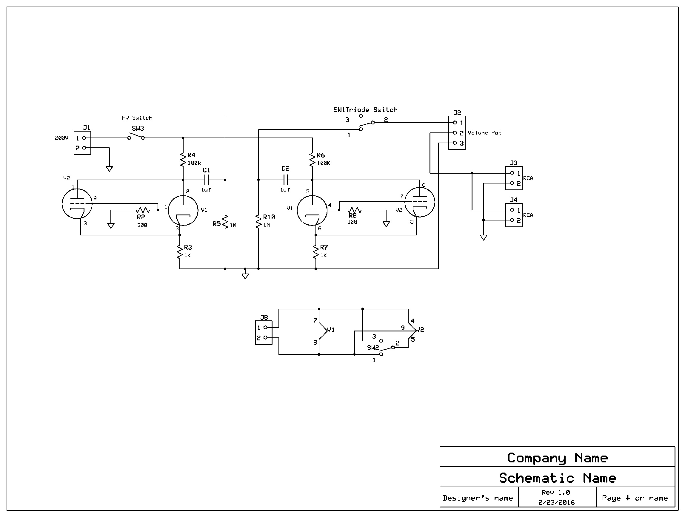

I am interested in testing some of my audio tubes, and Ive put this circuit together in order to test for hum, white noise, and microphonics and connect it to a simple amplifier, I have a few features incorporated such as a HV switch so that I can change tubes out with out having to power the down totally, and a switch for the heaters to switch from parallel and series connections. Ill be using about 220VDC for Testing,as well as Direct Current on the Heaters. One of the mains questions I have would be, do I need a simple opamp to buffer the output? Have a pic below Thanks.
First -- there was an Audio Engineering Society article by one of the forum members who discussed this topic -- not at the tip of my fingertips at the moment.
Second -- for tubes, the instrument you are using to measure noise must have high impedance
Third -- you've got to pick an operating point which is consistent among tube types.
Fourth -- to specify noise you have to bandpass filter and convert back to nano-Volts per root Hertz.

I'm just going to be using sound tests through an audio amplifier, I saw a YouTube video of a gentleman using just a simple box connected to an amplifier the only input was a HV and LV for heaters.

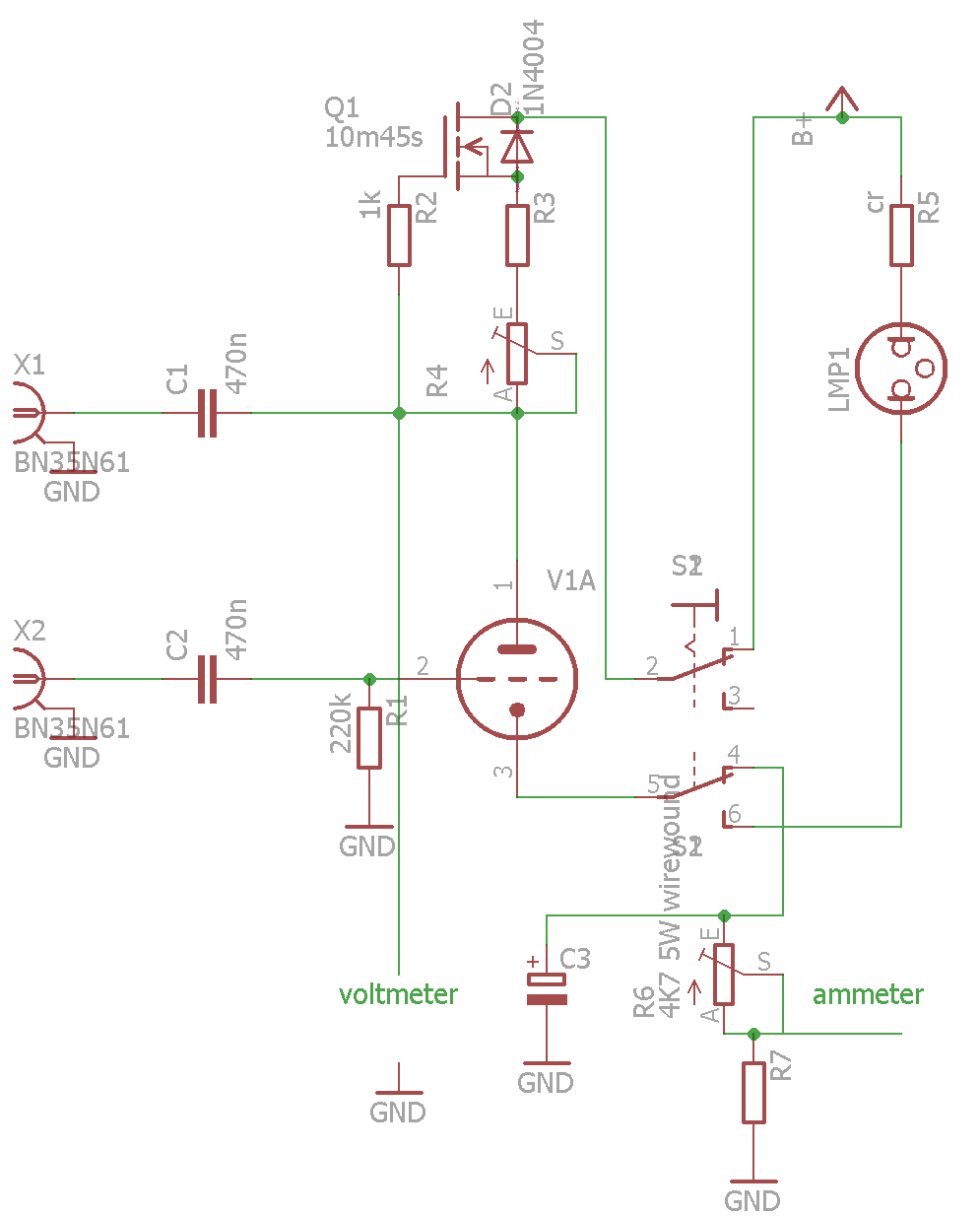

Here I tossed together a circuit i thought might give you some ideas.
Adjustable CCS as a anode load. Adjustable cathode resistor. And a switch that cuts out B+ and connects a neon through the cathode.
whilst you're at it you might even include some cheap chinese digital panel meters to measure the static anode voltage and cathode current.
