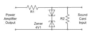

Bob Lee said:
My question is how to interface computer sound card to the device under measurement.
The output from the soundcard fits (usually) directly to to the amp inputs. Use a preamp if levels are not suitable.
The output from the amp need to be adjusted by a voltage divider. Attached is an illustration from the ARTA/STEPS manual. Suitable ressitors might be 10K/1K. The zeners are optional for protection of the PC.
For my own use I have built this together with a 8/4 ohm load, with jacks for voltmeter, scope, and PC.
This circuit is suitable for measurement of amplifier output, but not for internal measurements (do not connect to the anode of a driver stage!).
A scope is still required to look at 10KHz square waves etc. PC soundards are usually limiting bandwidth to 20KHz.
Svein
