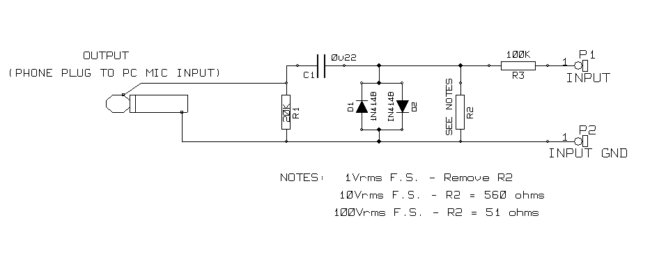

Very interesting... I am about to build this:
Your PC as an Audio Analyzer: Measure THD, S/N, Power Output, etc
Don't know if it works ok though.
pradigmshift ,
the circuit you propose is not serious, the diodes will be destroied with higher signals so also the sound card will be compromised.

It looks OK to me. Not perfectly optimum, but undoubtedly Good Enough for most use and very simple/cheap. The diode input clamps will protect the sound card; if they sacrifice themselves, they usually go short circuit, and they're 1000-5000 times less expensive than a sound card.
If the diodes have a fault these will be open for the signal so does not protect your sound card.
It is necessary a resistance before the diodes to protect these.
The 100K before the sound card introduce with the input capacitor of sound card a filter on high frequency limiting the band.
Disagree on all counts.
In a small minority of ultra-high pulse current failures, the diode bond wire can fuse open. But far and away the most common diode failure is short. There is a 100k resistor in series, so I can't imagine how much more resistance you'd want.
As far as HF response, the pole is formed by the 100k in parallel with the 20k resistor in parallel with the input resistance of the sound card (usually 10k) and in parallel with R2 (which can be open, 560R, or 51R) interacting with the input capacitance of the line card. If a line card has 50pF of input capacitance (which is more than any sound card in my possession), that f3 is about 300kHz with R2 open. With R2 at 560R, the HF rolloff is in the multimegahertz range.
The voltage ranges given in the schematic aren't exactly correct, but the right order of magnitude.
Thanks for the replies. The zeners are a nice choice but I will stick to the diodes, given the replies. Is there also an easy way to protect against ground faults (either faults in the amplifier/pc or accidental reversal of + and -?)
