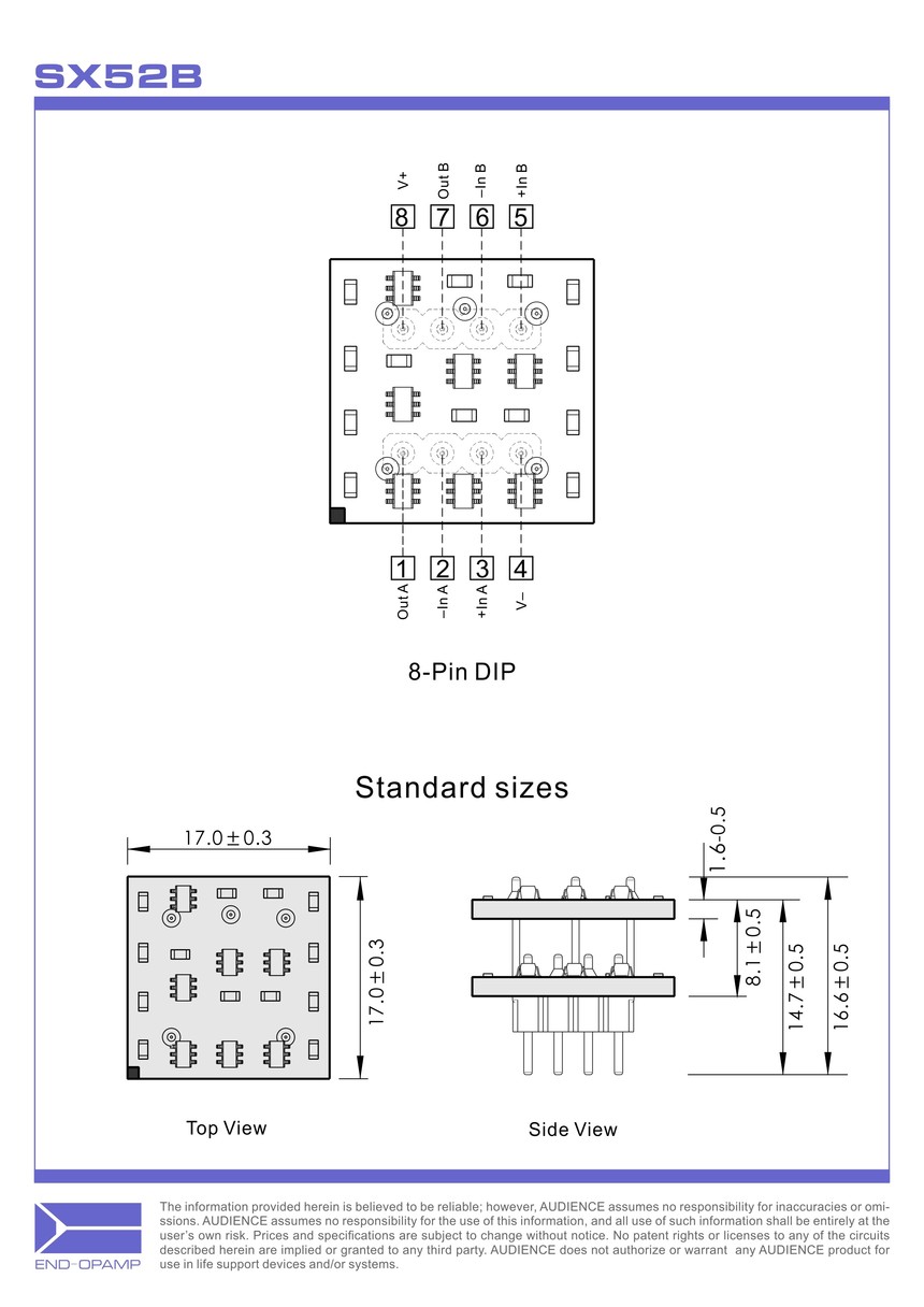

I can't find any decent datasheet for these SX52B's. What's the current noise? Are they immune from phase-reversal or latch-up? What's the driving ability (actually that ought to be reasonable given the immense quiescent current).

Yeah I don't know... I read that 30mA SOMEWHERE but there are hundreds of pages selling that op-amp and no one gives a decent data sheet. There was ONE with a more complete technical description but I can't find it anymore :-/

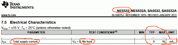

...five NE5532 ..... one op-amp quiescent current is 30mA?
NONE of the IC op-amps runs anywhere near 30mA. At 30V (+/-15V) that would be ONE WATT which is way too much for a precision 8-DIP.
The quiescent current is "always" on the datasheet. See attached.
http://www.ti.com/lit/ds/symlink/ne5532.pdf
Yes, this is no-load. If you run LARGE signal in LOW impedances, you must figure dynamic current. If you run up to clipping, multiply your load impedance by six and assume a resistor of that value rail-to-rail. 30V peak-to-peak in 600 Ohms: 6*600 is 3,600r, 30V/3600 is 0.008A or 8mA, two channels makes 16mA, plus the whole-chip 16mA Max is.....
Ah, I see. Yes, a very conservative design for a high-level low-Z console must assume 32mA per chip.
You are not driving 600 Ohms, possibly over 2k each amp.
You are not beating +20dBm (7Vrms) to flog miles of phone lines with steady tone, but under 2Vrms on peaks and average 0.2V. Your dynamic current is 0.1mA per amp, 0.2mA per chip, plus 8mA-16mA per chip for idle.
98% of '5532s will be far closer to 8mA than 16mA. Supply current is not a key parameter for a good audio amp but is tightly watched (if not Controlled) in production because current double what it should be implies a Problem in fabrication (crappy silicon, fuzzy masks, under-cooked...).

In this case I was talking about the discrete op-amps I'm gonna put to REPLACE the NE5532. discrete use far more current than ICs...

IB = 30pA with a BJT input? They have to be joking. Unless they found some hyper-superbeta BJTs. Even LM308 with ordinary superbeta IPS only manages around 1nA.
