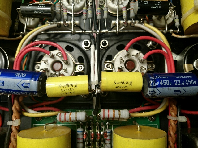

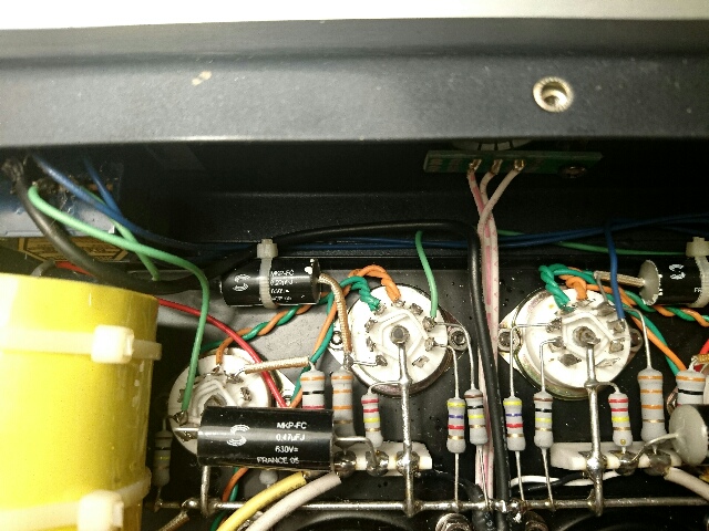

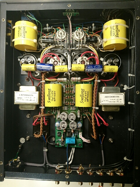

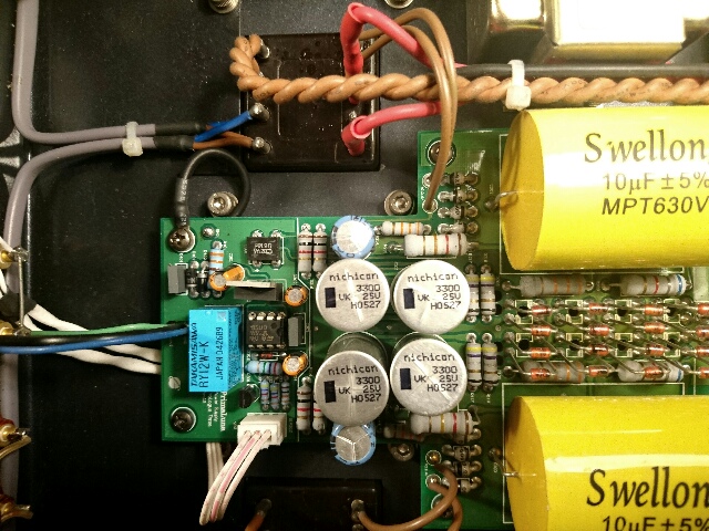

Here are few images from the internals.
Sorry for the cell phone quality..
First one is overall layout. First capacitor close-up is from the front end, second one from the middle, last one close to the rca jacks.
In the last image the green, blue, black and white insulated wiring goes to pre-outputs. Btw, vol pot is Alps Blue 250k.
Best,
M

I checked and at least, if trusting the text on the pcb it should be the power supply board. This is clearly printed on the lower left corner when looking at the last image. Of course it´s impossible to see this from the small file attached here.
When looking at the first image two left jacks are pre-out, third is tape out and rest are inputs

I will keep studying the layout later on to find the right caps. I might drop an email to the manufacturer and see if they are willing to give more details. I will get back.
