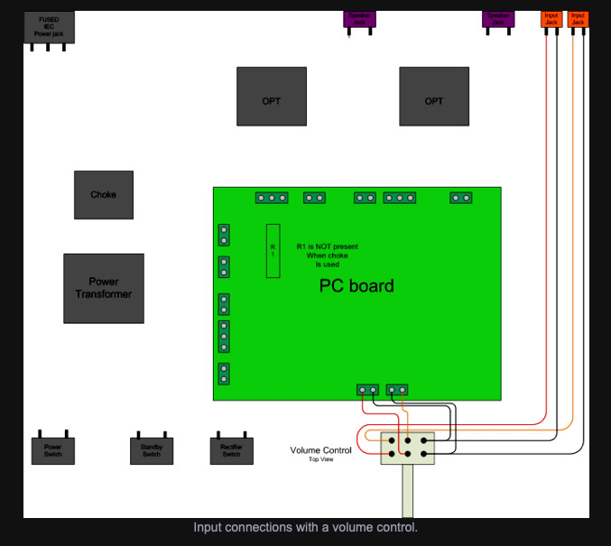

is it possible to use Tubelab SE assembly manual and parts list even for TSE-II?
In case the manual and list is just for the old SE pc board where can I can the info for TSE-II, thank you.
The assembly manual for the TSE-II is still being compiled. There have been a few delays that are beyond my control right now which will likely persist until early January.
For now use the parts list (BOM) in post #1 of this thread for the parts to stuff the board. The procedure is pretty much the same as with the old TSE board, as the off board connections. There are also several completed amps in that thread with pictures.

I had the same questions...the quick answer is you can use the old SE board info. If I'm wrong, someone should correct me.
What I did was read the TSE forums and the Tubelab website. From what I've gleaned from the two is that one or mores solid state devices became obsolete. Otherwise the mod I and mod II boards are the same.
Mr. Tubelab usually will respond to questions on the Tubelab forum here within a day or two. From what I've read, he has had quite a few life changes the past few years and hasn't had time to write the TSE-II assembly manual and parts list.
However, there is a spreadsheet posted with all the parts you can click on and it will give you all the parts from Mouser. Search for TSE-II parts. I just ordered all my parts for a TSE-II board. All the parts listed are available, and all you have to do is click on the link.

For grounding and the motor run capacitor, I used the wiring diagrams given for the Tubelab SSE amp.

I read the original TSE docs thoroughly before beginning mine, and it helped immensely. However, I saved the pitchers for after it was up and running. 😛

So the wiring of SSE is the same with SE or it is usable just for motor run cap ? Can I use the wiring for volume controll?
