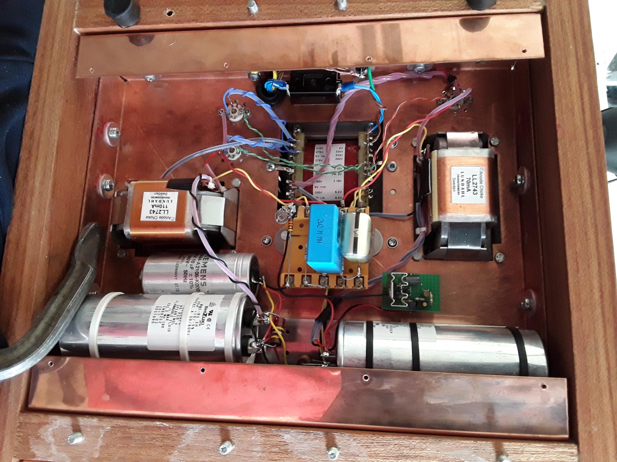

I would try to find some oil filled Shizuki capacitors on ebay. Shizuki and Asc are somehow related. The Japanese caps are very well made. Even if they are just metalized caps they can supply enough current for any SE amp and by the way if you want the best results you should try to go for a choke input power supply. Greetings, Eduard
P.s in the attachment you can some Shizuki in my line preamp
