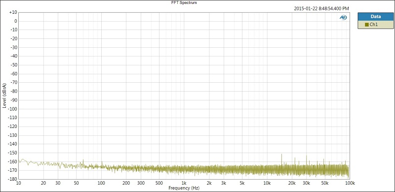

Hi and sorry to jump in a little OT.
I am using Arta to evaluate some usb AD/DA interfaces.
I am only able to check the noise floor of the interfaces for now 😱 🙁
But i would like to check the noise floor on DAC only units i also have at hand.
(or only the DAC section of the above mentioned interfaces).
Do you think it is possible ? i am very lost here.
In practical terms i would like to see the influence of galvanic isolation and different power supplies on different dacs.
Like they have done here (see at the bottom of the page where there are graphs with and without galvanic isolation).
http://www.exasound.com/e12/e12Measurements.aspx
http://www.exasound.com/portals/0/Images/e12-Measurements/exaSound-e12-DAC-Noise-Floor.jpg
http://www.exasound.com/portals/0/Images/e12-Measurements/exaSound-e12-DAC-No-Galvanic-Isolation.jpg
