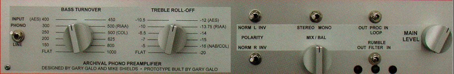

You might enjoy studying the "archival" phono preamplifier design published in Linear Audio magazine, volume 5. (web link)
An Archival Phono Preamplifier is a phono preamplifier designed for playback of vintage recordings long-playing, 45- and 78-rpm records made before the RIAA curve was universally adopted by the recording industry ... ... Although there are some (expensive) commercial preamps available with customizable replay characteristics, Gary Galo found them wanting and has over the years developed a phono preamp designed to replay all these different formats and recording curves. That design is described in this article.
There is a photo of the device on the magazine cover, see below.

Hi Mark, is this an OPAmp?

Neat trick that Mr. Galo used...
