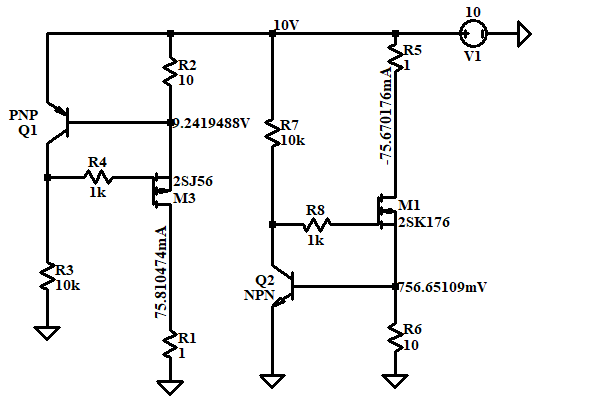

I would test those Pchannel mosfets by configuring them as current sinks using a pnp to control the gates. Nice find. They appear to be lateral mosfets which aint cheep these days. Hope they work.

Depends if you have a lab supply and some experience. I killed some transistors by connecting them the wrong way. Would be a shame if you killed some in testing. I think you can probably trust your DCA75 to see if theyre broken or not.
Anyhow I recently used something like this to match for Vgs:
If you indeed use current sources to test tripple or quadrouple check all connections.

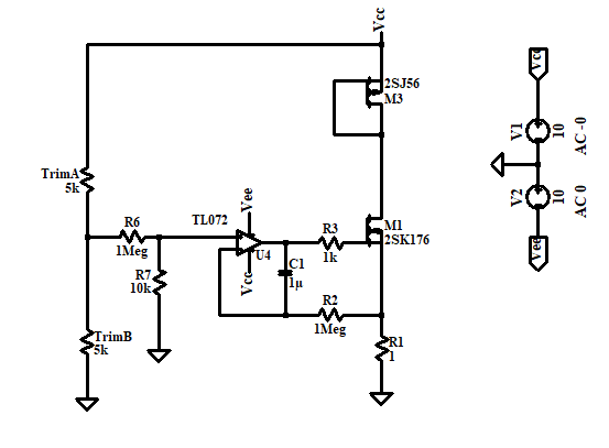

Even better is using an opamp:
