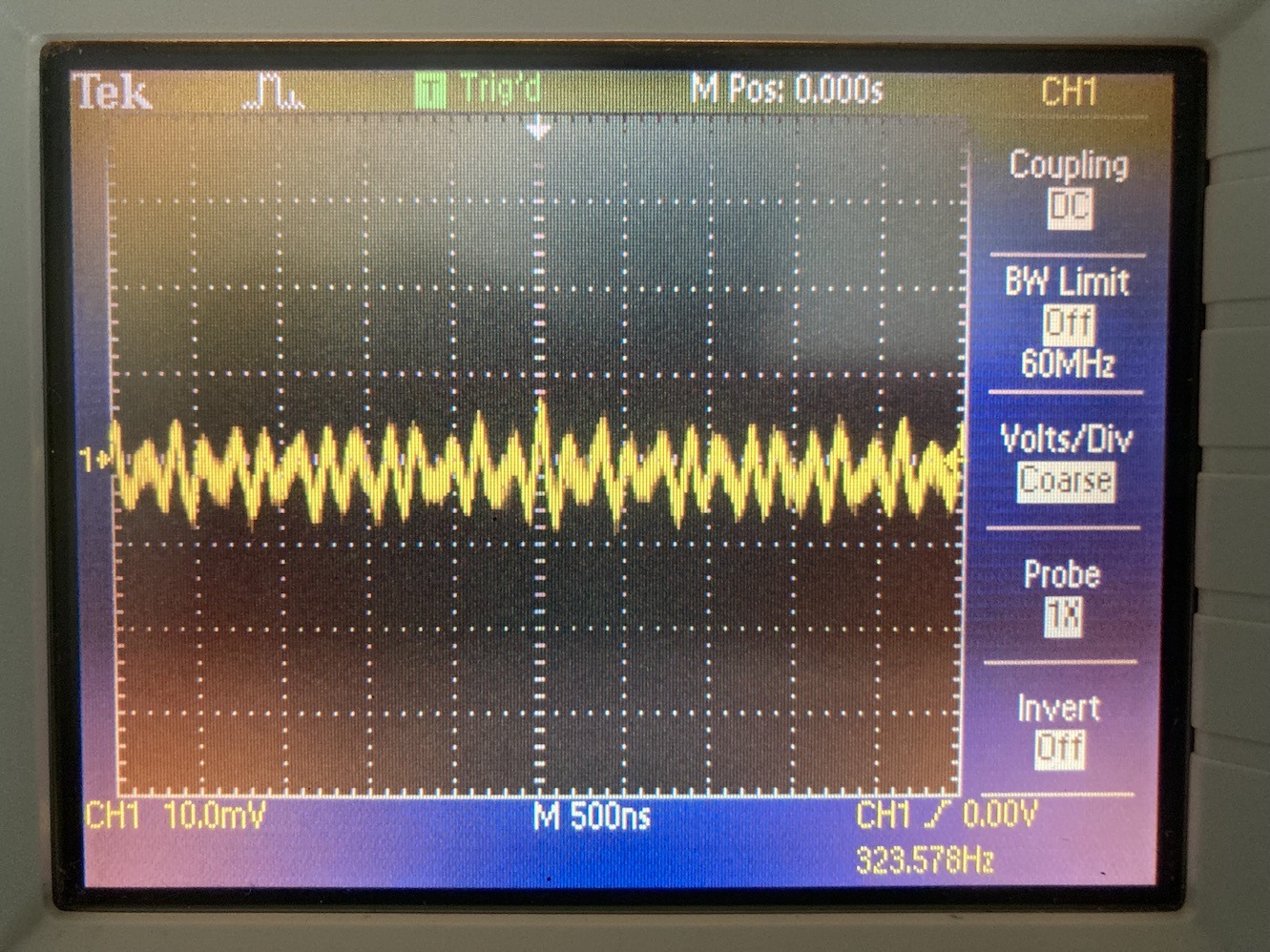

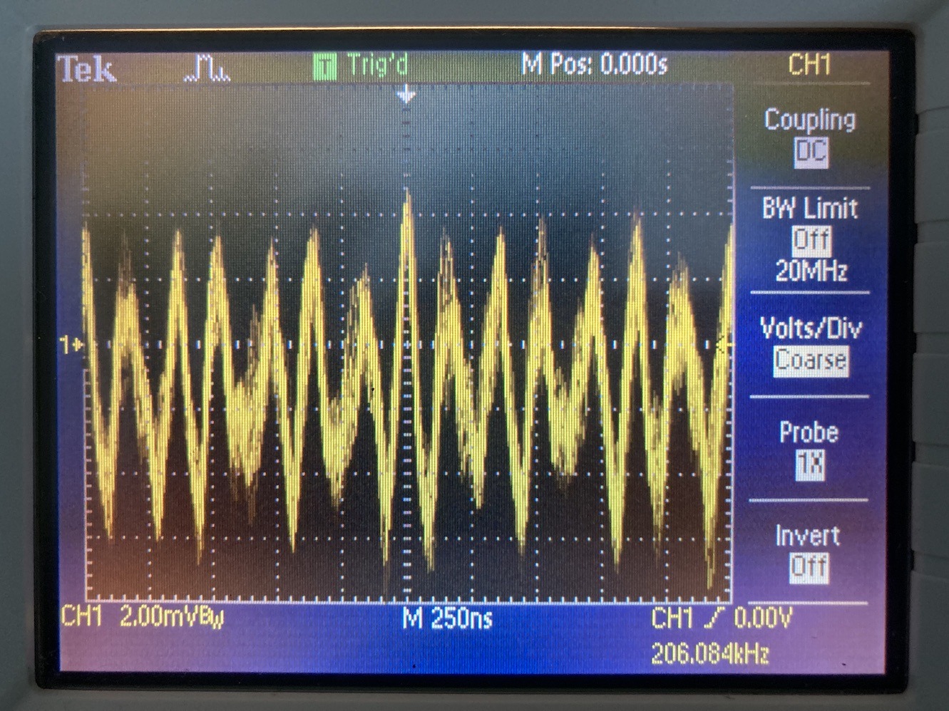

I'm reaching out to the community to discuss and compare others' experience on the ARCAM FMJ CD23 (not CD23T) noise floor.
I bought it a year ago and upon having the laser replaced I used to listen to it from time to time. Recently, however, I've discovered a surprisingly high noise that you can distinguish by wearing headphones and cranking up volume before switching on the player.
Upon the player switch is pressed, for a few seconds the noise level remains as if the player was still off, but as soon as you hear the output relè click activating the channels' output, a subtle but distinguishable noise pops up. I'm not talking about any music reproduction defect but of the noise hearable by simply switching on the unit.
A comment on a slightly higher noise-floor was reported by John Atkinson when he recapped device's measurements in his article, but before digging down to find a potential electrical cause in the DAC board which, being multilayer, is not easy to fix I would appreciate if any other CD23 owner can share their experiences
Cheers, Riccardo
These are two pictures I took for referencing connecting scope to one of the channel's outputs.
A common cause of a high noise floor on the CD23 audio outputs are the failure of some capacitors on the DAC9 board. So on the DAC board I would suggest you replace C30, C38, C97, C98, which are 10uf Non Polar electrolytics. Also replace C2, C4, 100uf electrolytics with any good quality low esr, 105 degree components.
