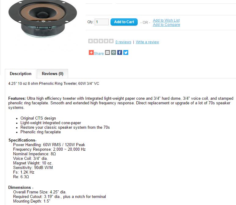

system7, thank you for the information and the link. I managed to get the replacement tweeters for $4.00 each. So I bought all they had....8. I have a pair of AR17's that can use some new tweeters as well. Once I revamp the crossovers in the AR38's, I am going to cover them in real wood veneer. I think these will be a keeper.
$4 a pop is a great price :
Phenolic Ring Tweeter Replacement for AR-4X CTS Marantz and More 8 Ohm
rgds, sreten.
rgds, sreten.
