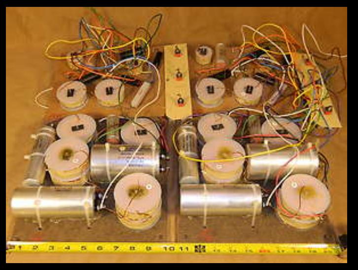

Going to jump in here; neighbor has a working set ar9s (re-foamed), but one of the tweeters is louder than the other.
I guess we can pull them out and bench test them. Are there any upgrade ideas; e.g. better tweeter caps?
That's some xo! I hope this is for both sides.
btw, he's using a active car xo and separate amp for bass woofers.
