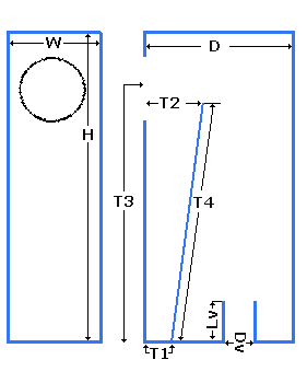

Hello, could anyone help me to find useful documents and simulators for this wonderful type of loading? I've found Martin J. King references but all related to his worksheets that I wasn't able to run.

All can handle various types of tapered pipes. Although I'm not sure why a TQWT is 'wonderful'. It's just a particular type of cabinet load (a parabolic horn, assuming you're referring to a pipe with parallel sides expanding toward the terminus), with its own balances of advantages and disadvantages.

TQWT in my opinion may be wonderful because nothing else until now has been able to make sound a 6.5 inches paper cone like I've listened, one of the finest, rock solid, dry but extended bass response ever heard. Certainly other TQWT I've listened was boomy or anything else but at least one TQWT was the best two way ever listened so I've decided to study about it.
Thanks for the suggestion about simulators, but any theorical well made treatment about TQWT?

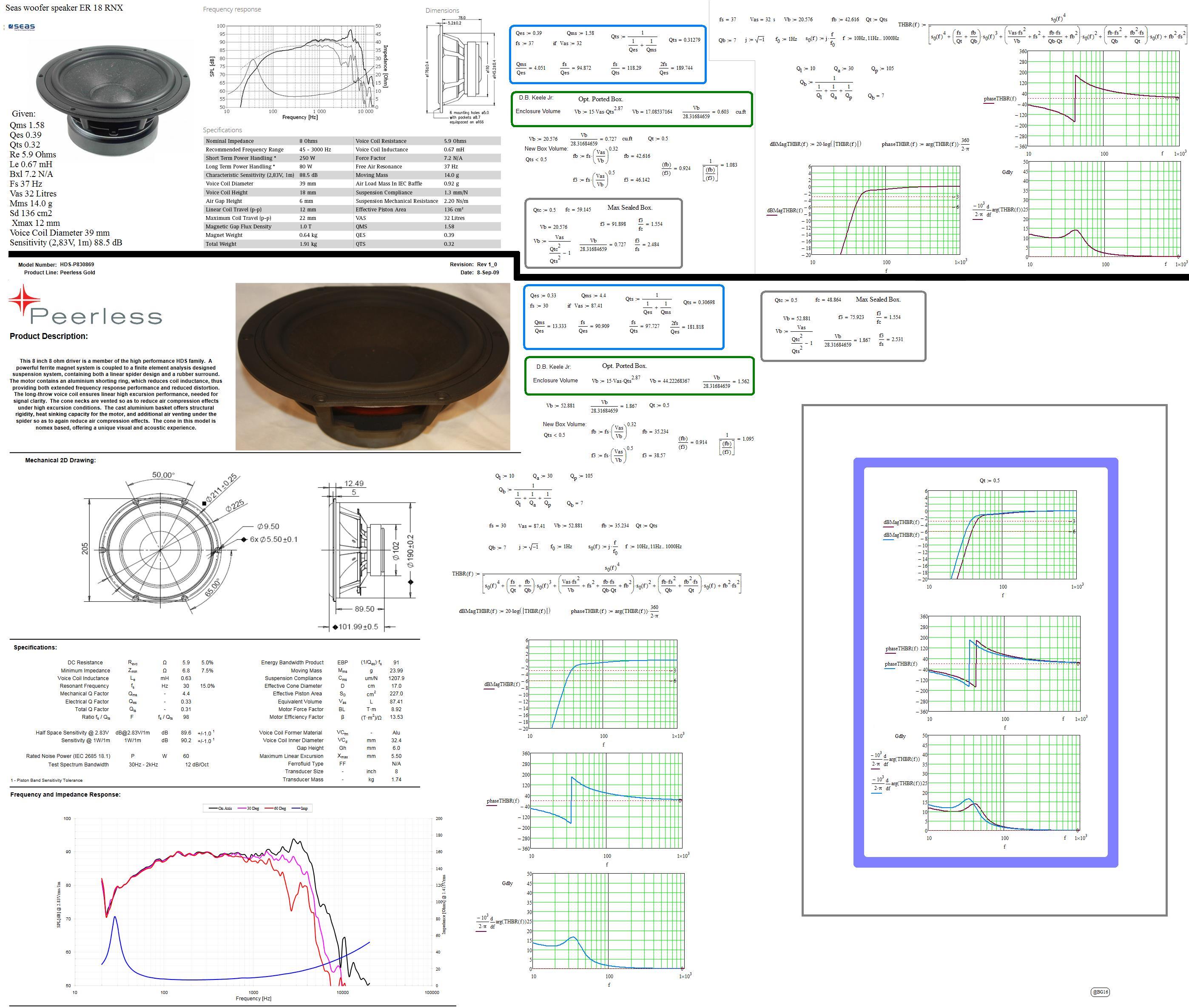

Excuse me for the late, great, thanks! Let's go with order: woofer I've listened and liked/loved has these parameters (I prefer not to say brand and model to respect author's work and intellectual rights..), it was just a 6.5'' woofer that we can call "woofer A":
Qms 1.58 / Qes 0.39 / Qts 0.32
Re 5.9 Ohms / Le 0.67 mH / Bxl 7.2 N/A
Fs 37 Hz / Vas 32 Litres / Mms 14.0 g
Sd 136 cm2 / Xmax 12 mm / Voice Coil Diameter 39 mm / Sensitivity (2,83V, 1m) 88.5 dB
Apparently one of the thousands "normal" drivers available on the market at reasonable price. I was convinced that for a punchy sound driver must have high Qms and high Bxl, I'd never have chosen this driver: I didn't believe my ears listening it in that configuration.. Author didn't know me and told that driver was working in a sort of mix of trapezoidal labirint and bass reflex, didn't tell me anything else, but it was obvious for me that I was listening the best ML TQWT ever heard. Box was approx cm 90x25x40 (HxWxD), port was downfiring against a marble basement about 10 cm far. Impact was really really exciting, bass extended but not boomy, a sense of solidity and strenght never heard before.
My idea is to try to repeat that project or project a similar one using the Peerless 830869 HDS 8'' instead, which I court for long time; I can use a pair of SIPE tweeter (recycled from my old Chario Syntar 2 but still in good conditions) because I like them very much and to set up a simple and cheap but good sounding two way system.
Now I would use the woofer A parameters and try to project a system to see if I'll obtain a box similar to the listened one, and after try to project one ad hoc for the Peerless.
One of the most misunderstood things is the necessity of a high Qts driver as seen somewhere: woofer A doesn't have a high Qts at all and worked well in a about 60-70 litres cabinet..!
However, I'll try to make some simulation this weekend using calculators you suggested, yesterday I just took a look to LeonardAudio TL simulator and I've found it very versatile but I must learn a method to scratch the basic dimensions stating from driver parameters, as Qts more than Sd and Fs.

You've been talking about TQWTs and now a ML-TQWT, so which is it and which way does it taper?
FWIW, I did an inverse tapered TQWT since these drivers are low Qt and both look typical for the genre in ~80 L with a gradual roll-off below each driver's HF corner [~2*Fs/Qts], basically a mid-bass alignment tuned to ~32 Hz.

@ Bjorno: thanks for simulations, but I don't understand in what type of TQWT are made, can you post a scratch please?

However, of course, I'd want to understand TQWT but system I've listened I believe was a ML TQWT. Please help me to make clarity: if I don't go wrong a TQWT is a transmission line with narrow in the top and large in the bottom where there is mouth with woofer mounted at 2/3 of total height, in folded variation in which it assumes a normal rectangular lateral shape. After, there's the ML variation (Mass Loaded right?), in which the mouth is substituted by a vent, that brings to the system a lower Fc and better harmonics filtering, called ML TQWT, have I gone right?
If yes, the listened system was a ML TQWT because I felt through hand the circular shape of a vent in the bottom of the cabinet firing against marble as said. So I suppose that inner shape of cabinet was like this:
Do you intend this for "inverse tapered TQWT since these drivers are low Qt" or other else? If so can you attach a scratch too of what you intend please?

What you are describing as a TQWT (mass-loaded or otherwise) is technically a Voigt style tapped parabolic horn; he partially described lines like this as tapered quarter-wave pipes in his patent of the 1930s. In GM's parlance (and mine, since I've adopted it, but I suspect we're the only people left in this camp) a TQWT is the opposite, i.e. a pipe that contracts toward the terminus.
Be that as it may, an expanding pipe (aka 'horn') operates over a wider BW than an untapered pipe or one that contracts toward the terminus. Ergo, it can be useful for a low Q driver with a moderately high mass-corner frequency, since they tend to need more output from the enclosure over a wider frequency range. Note system Q rather than necessarily the driver Q alone is significant here -depends on the output impedance of the amplifier and any series R in the circuit.
