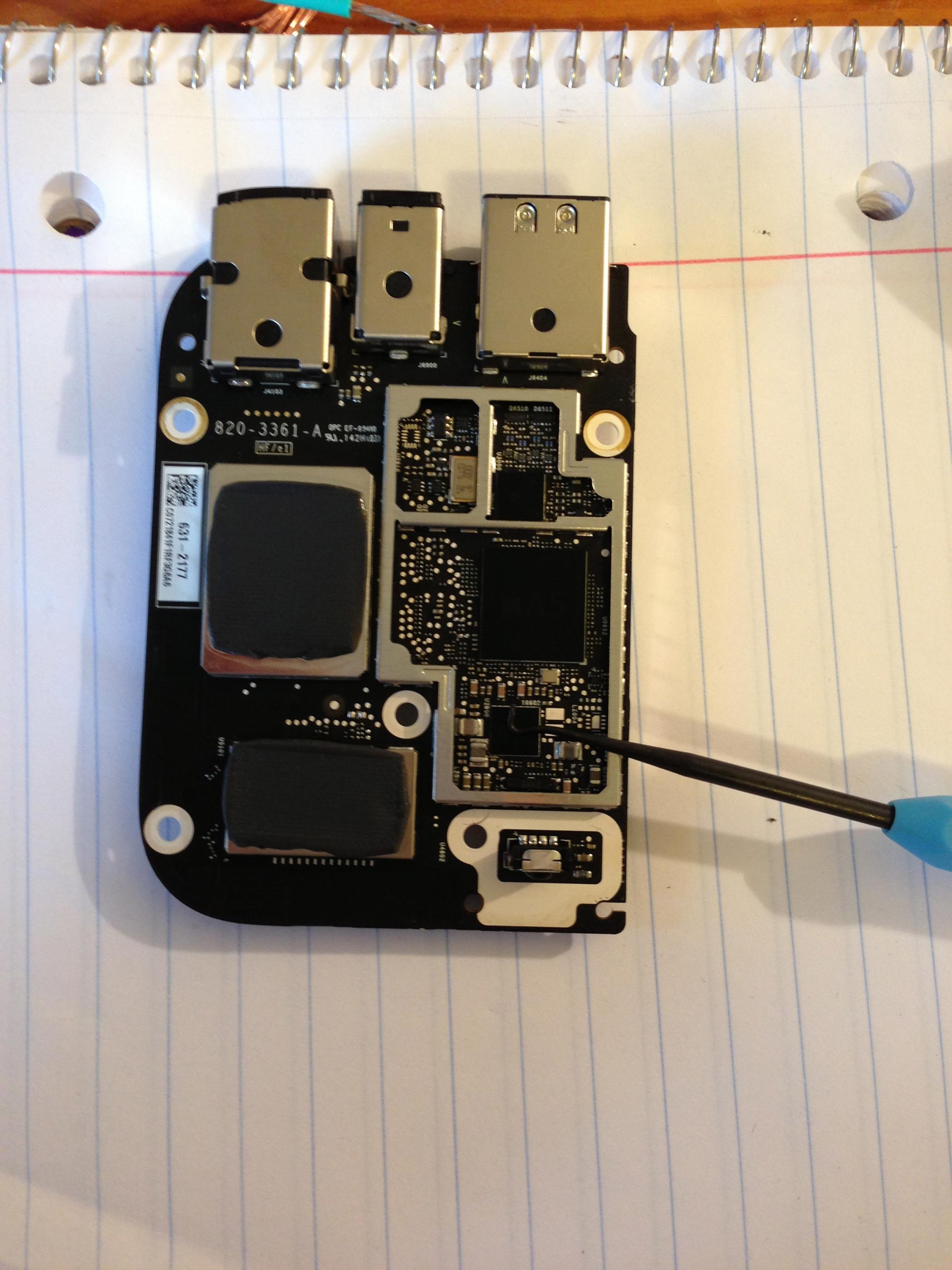

So I've opened my ATV3 and realized that soldering any connections would be next to impossible. Also the ATV3 uses a 27.xx clock.:mad:
If someone has a broken ATV that they would like to donate to mad science I might proceed further.
