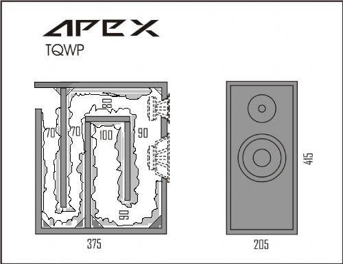

TQWT box idea for 6 inch driver.
A nice looking box, but which 6in driver in particular? Since like any other vented alignment the box tuning & volume of a QW pipe need to be appropriate for / designed for the intended drive unit's requirements, it would be useful to know which you had in mind.
Many 6in or 5in drivers can be used and tuning response with damping material.
This box is idea for test TQWT and I will share project with crossover.
Regards
Indeed! A TQWP as shown would want a fairly low Q driver. A high Q driver would need an entirely different folding to place the driver nearer to the closed end. Finally, the overall volume of the pipe would depend on the Vas of the driver, which is all over the place in available 5-6" drivers.
Bob
AH! OK.
My first impression looking at the T/S parameters is that a Qts of 0.38 may be a little high for a TQWP, but probably doable. The Vas of 13l, though is going to produce quite a challenge making the passages small enough.
Good luck!
Bob

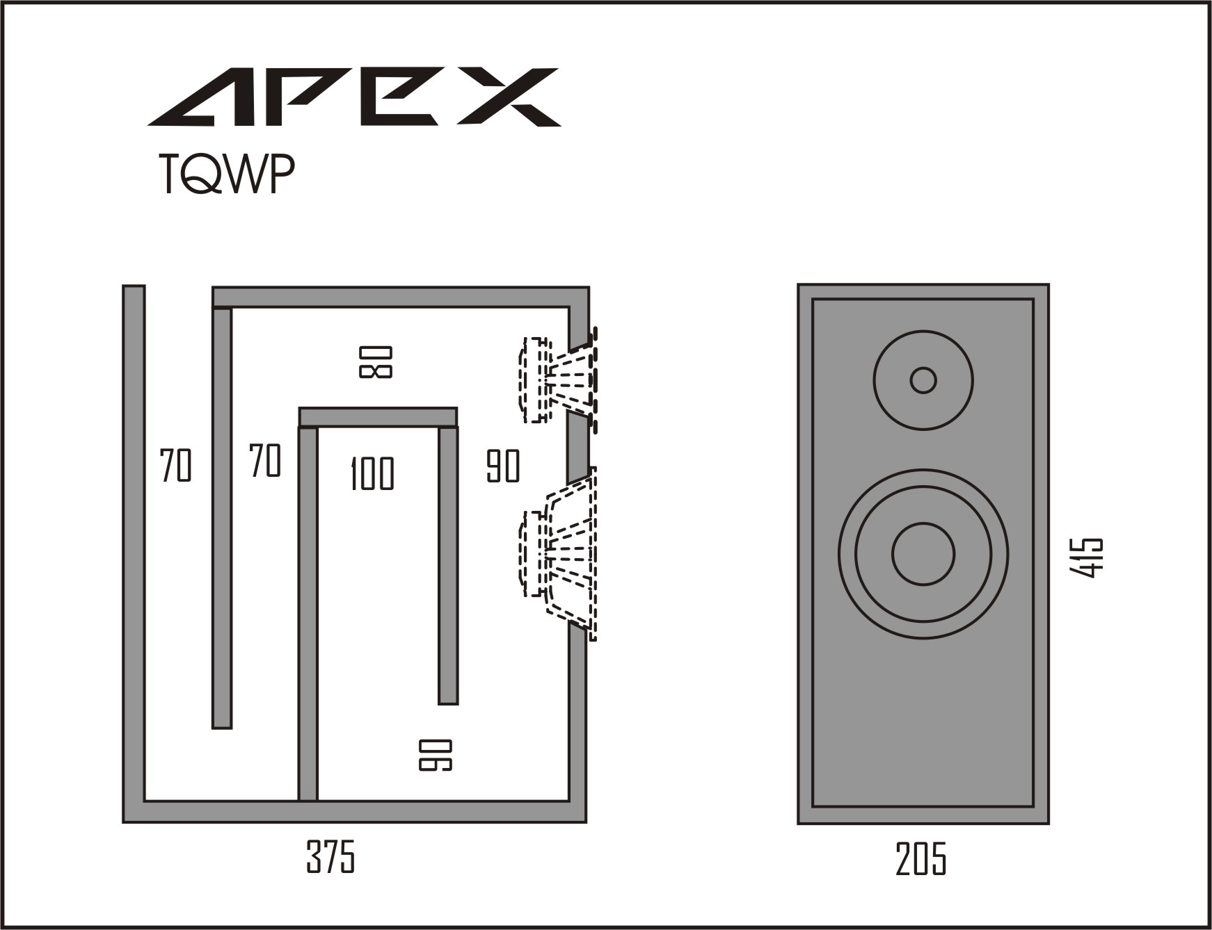

what is the board thickness? I cannot calculate it from this diameter chain...
seems to be 10 mm but (375-90-100-70-70)/5 gives 9mm
something is wrong on the picture, mr Apex.
It could be that the 375mm refers to the internal distance not including the front and back. So boards would be 15mm. It won't matter much from tuning standpoint or performance standpoint whether or not the overal depth is 375mm or 385mm.
