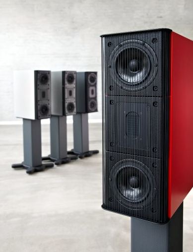

My friend, I can only try and answer your questions. You told me you can get a SEAS ER15RLY for $45 a pop. Sounds like a bit of a bargain to me.
I think they will work well enough in some CA15RLY design:
This one went for 21,000 Euros a pair. 6moons audio reviews: Gryphon Audio Designs Mojo
I don't think any speaker is perfect. This one doubtless lacks bass. Maybe Scanspeak do a better 5" driver. SEAS can push the boat out into their higher Excel range too. But you won't have a bad time with those Prestige ER15RLY drivers IMO.
I have heard this sort of MTM with a ribbon stuff. About as good as it gets, IMO.
