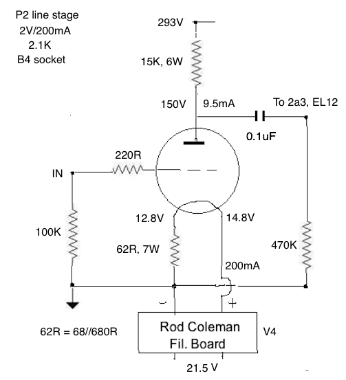

I'm now listening to a newly put together P2 stage. Actually CV1246, courtesy of Langrex. Schematic attached.
First observation - these valves are microphonic. Bump the chassis and you get a merry tune. Leave the chassis alone and they're OK. My chassis is 4mm aluminium and I don't usually have problems with microphony, but a lighter chassis might.
Sound quality. My usual stage is a 26 lately, rotating with a type 47. These are the driver stages for my EL12n 2 stage SE amp. These two DHTs have a fair bit of filament current going through them - 1A and 1.75A. This seems to add weight - and bass impact - to the sound. Sounds like a simplistic observation but that's what it sounds like. But from the upper bass upwards the P2 is very nice - clear, clean, neutral with plenty of nice treble detail and no edge to the sound. It brings back memories of the Type 30 I used years ago, but I'd say it was better than that.
So yes, I like the sound and I'm enjoying a variety of music - voices are nice, orchestral music has good timbre, tone and detail. Piano is nice. Plenty to like. I'll leave it in my system for the rest of the evening and see how it goes. I miss the fullness and weight in the bass I get with 26 and 47 - it's a rather lighter sound overall, but for what it is, it's very clear and pleasant. So a qualified approval. I expect I'll go back to my 26, but I'm in no hurry. I'm enjoying the clarity the P2 brings. I didn't have issues with microphony when in use, but others might. If you can deal with the microphony I'd suggest this is an interesting choice of valve for the upper part of a 2 way active speaker.

Well, the P2 stage is still in my system a few days later. It rings a little if I cough near it but that's all, and it goes away very quickly. The tone is really nice and apart from the rather light bass response it's all good. Very nice high end and a true DHT sound. Not for everyone but what it does, it does really well.
Maybe I should put more current through it and lower the value of the anode resistor. Data shows up to 17mA.
