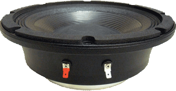

10MCF400Nd
The 10MCF400Nd is a fascinating driver. I stumbled upon it while searching for the unobtainable 102Nd/N. These 2 drivers have a lot in common. Especially if one opened the basket bringing the Qes and Qts back below 0.1.
It looks like the 10MCF400Nd was made as a much more rugged replacement for the 102Nd/N. Of course, the closed basket changed the T/S parameters thereby concealing a hidden gem.
I would be very interested to hear more from existing users about how it sounds.
