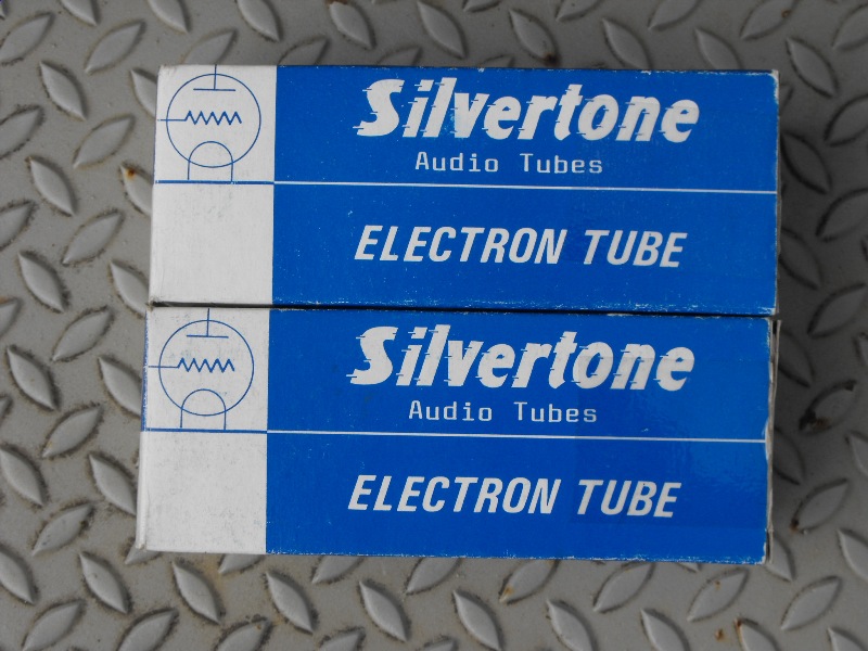

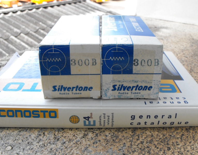

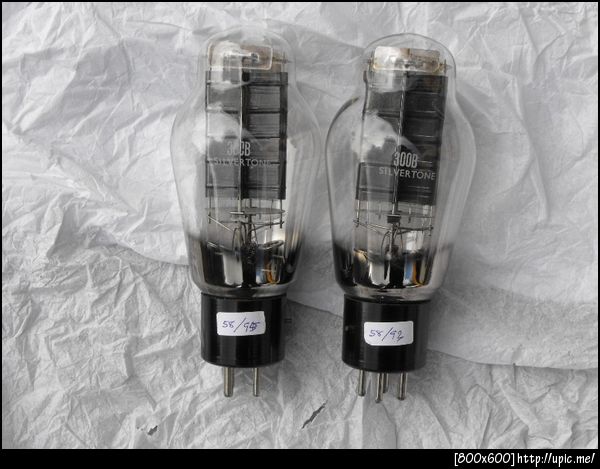

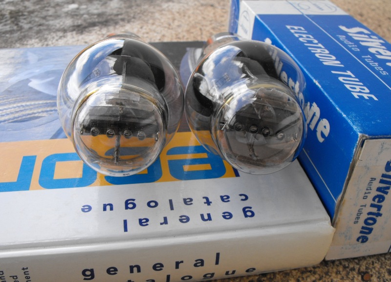

I did not familiar with this kind of tube. Could you please advise per attached pictures?
Regards, :)

I wouldn't say so, definitely NOT a WE 300B, and looks Chinese to me. I'm not aware of the "real" Silvertone selling 300B at any time in their history.. The boxes appear to be deliberately made to look more than a little like the WE 300B box in terms of color and design. Silver Tone Audio is a company based in Singapore apparently - not one I am familiar with and this appears to be a re-branded Chinese tube - unless very cheap not worth the money IMHO.
Here are examples of some USA Silvertone boxes that would be period correct:
Tube Box Art
This is what a real WE 300B looks like - look at the size of the mica insulators and the plate construction: http://www.google.com/imgres?imgurl...a=X&ei=NhC_TKDQIIaglAfNleTjBw&ved=0CCYQ9QEwAw
I'd go for a set of TJ or Sophia meshplates, or the solid plate JJ 300B instead.
