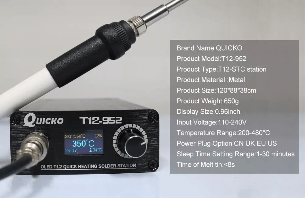

A few years ago, my Weller TCP failed. While waiting for a replacement heating element, I bought a T12 from AliExpress. This one becomes my daily driver for over 5 years, even after the Weller is repaired; it's so much more convenient, for about $40 shipped. The only downside is the useless default tip, so buy the kit with a few more tips and a stand.

This is interesting. Could you pls give a link to spare tips?A few years ago, my Weller TCP failed. While waiting for a replacement heating element, I bought a T12 from AliExpress. This one becomes my daily driver for over 5 years, even after the Weller is repaired; it's so much more convenient, for about $40 shipped. The only downside is the useless default tip, so buy the kit with a few more tips and a stand.
