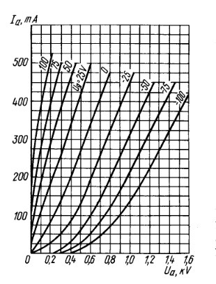

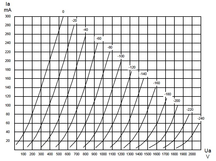

Anyone done their own curves for GM70?
Joined 2008
The two sets of curves easily found on the web have fairly substantial disagreements. The prettier set comes from an English only page, but without confirmation there's no reason to believe it over the less than wonderful (for audio) looking manufacturer's sheet. Has anyone done their own set?
