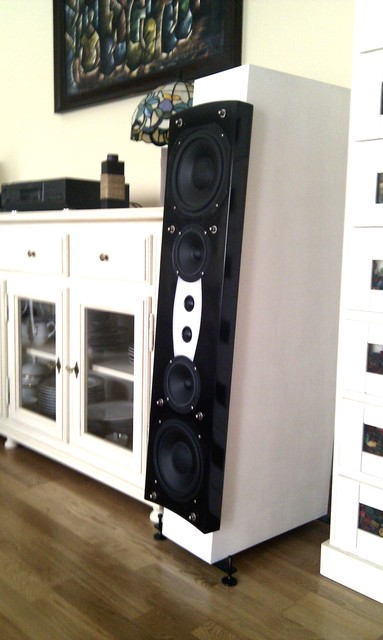

I´ts not my intention to duplicate Dynaudio loudspeaker sound..the only goal to achieve is a combination of drivers in the same way of this device, including the double tweeter in a moulded piece.
In reference with the xover it will be a passive two way network for mid en high drivers...woofers will be guided for a dedicate active filter and power amplification..like evidence c7 do.

I do agree with Miksin, if you like the sound, go for it and pay the price. But... for some fun... this is ok. I am really satisfied with the sound... after some "burn in" the 21w54 got better and better... high are sooo delicate, mids are very clear...
You can talk direct to some parts retailer and get the tweeter T330 at least. I am sure it is possible, as I got some of my drivers.
design is well known by this community.
My approach has 21W54, 15W75 and D260. But if I could afford, it would be 20W75, D76AF, T330.
Xover is 1st order, Solen caps, solen perfect lay inductors, caddock T247 packing resistors, known as girator config, phase adjusted. Inside cables are VanDenHull CS122, double wall MDF, HDF front panel, inside damping mat, glass fiber filling, vented configuration, tuned for 42Hz.

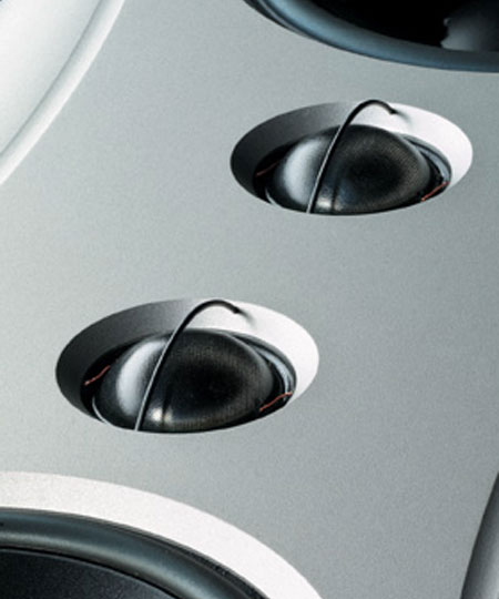

Technical Reason for the double tweeter aera
until this day I haven't understand the mind and the justify for the double tweeter aera by this series.
In all papers and books, that I know, is to read, that such a step are to avoid under all circumstances cause the still presently inteferences as unwanted effects. Are there any convincing reasons, that justify this design?

my usage of it...
I am not sure about Dynaudio approach for the dual tweeter, I think I read somewhere one of it is for high frequencies only...
My case is: One D-260 cuts out lows for 1.8KHz and the other starts to sing only at 10KHz and up, 3dB lower. The lambda (wave lenght) of 10 KHz is so small that interference between them is no trouble. But the acoustic effect, giving "air" is remarkable. I experimented with and without it... they stay in, with a Hovland MUSICAP capacitor in series.
There's also a peak of response in the D-260 curve, somewhere 12KHz that appears to resolve using this approach. I never analyzed deep to understand...

I was under the imprrssion that both tweeters play lower frequencies, but the lower tweeter is rolled off where two combined tweeters would start to beam.
This gives better power handling than just one tweeter, but maintains the dispersion.
