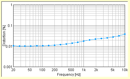

Let me show you an audio related curve, showing the output at 100W RMS 4 Ohms vs. freq. The signal shown actually passes through a ferrite choke, with no feedback after the choke.
I repeated the same test with an air coil, and it was not noticable better. So i am convinced that most of this (rather limited) distortion comes from other places in the amplifier, not the ferrite core.
Frankly there is not much of a difference. I have an aircoil with exactly the same value as my ferrite inductor. But i was never able to solve any 'problems' with the aircoil. So though in theory the aircoil should have a lower distortion, than the ferrite coil, i have not been able to confirm this with real measurements.
