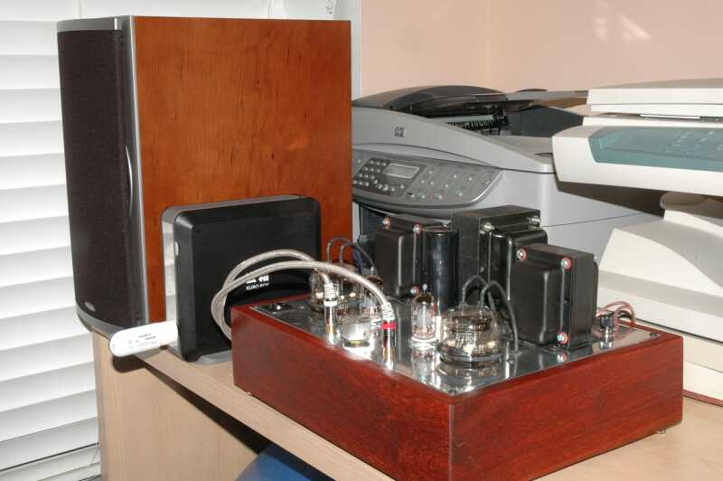

Since this is a DIY forum I'll show you my homebrew MP3 player. It is a Buffalo NAS device hacked with Gentoo Linux and mp3 software. I control it through my cell phone across the internet and it has a 300 GB hard disk in it. Here is a wiki article describing the software:
http://buffalo.nas-central.org/index.php/John's_Suggested_MP3_Player
and here is a photo of an early version connected to my 832 amp. It will soon have a usb dac in place of the usb sound card. I have this same setup at my office connected to my 6AU6/6AQ5 amp.

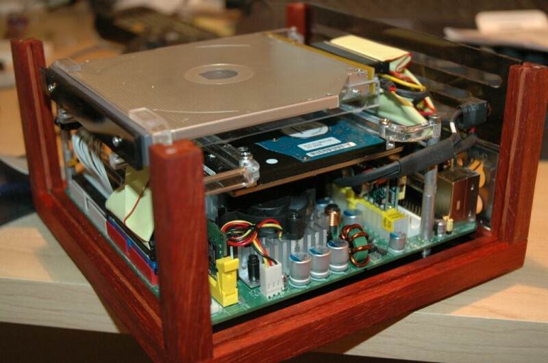

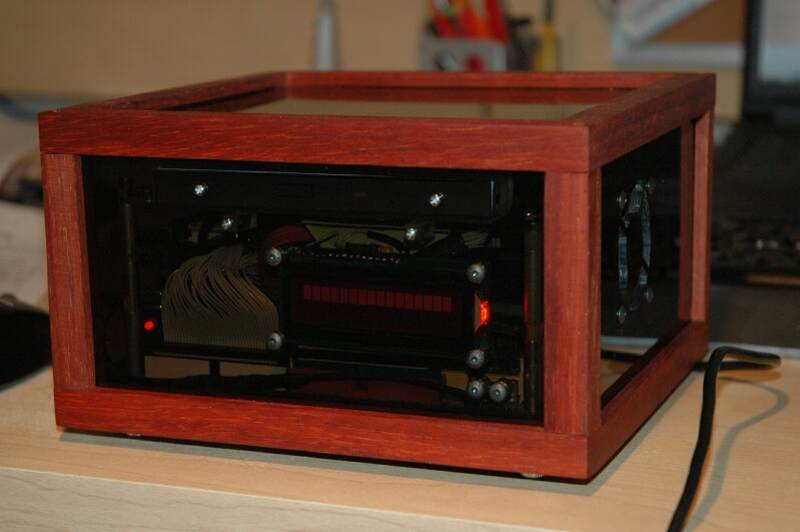

i go with either a standalone hdd player most of them have spidif out other than the really cheap ones. or if you want to build something check out http://www.mini-itx.com/ and you could build your own media player.
