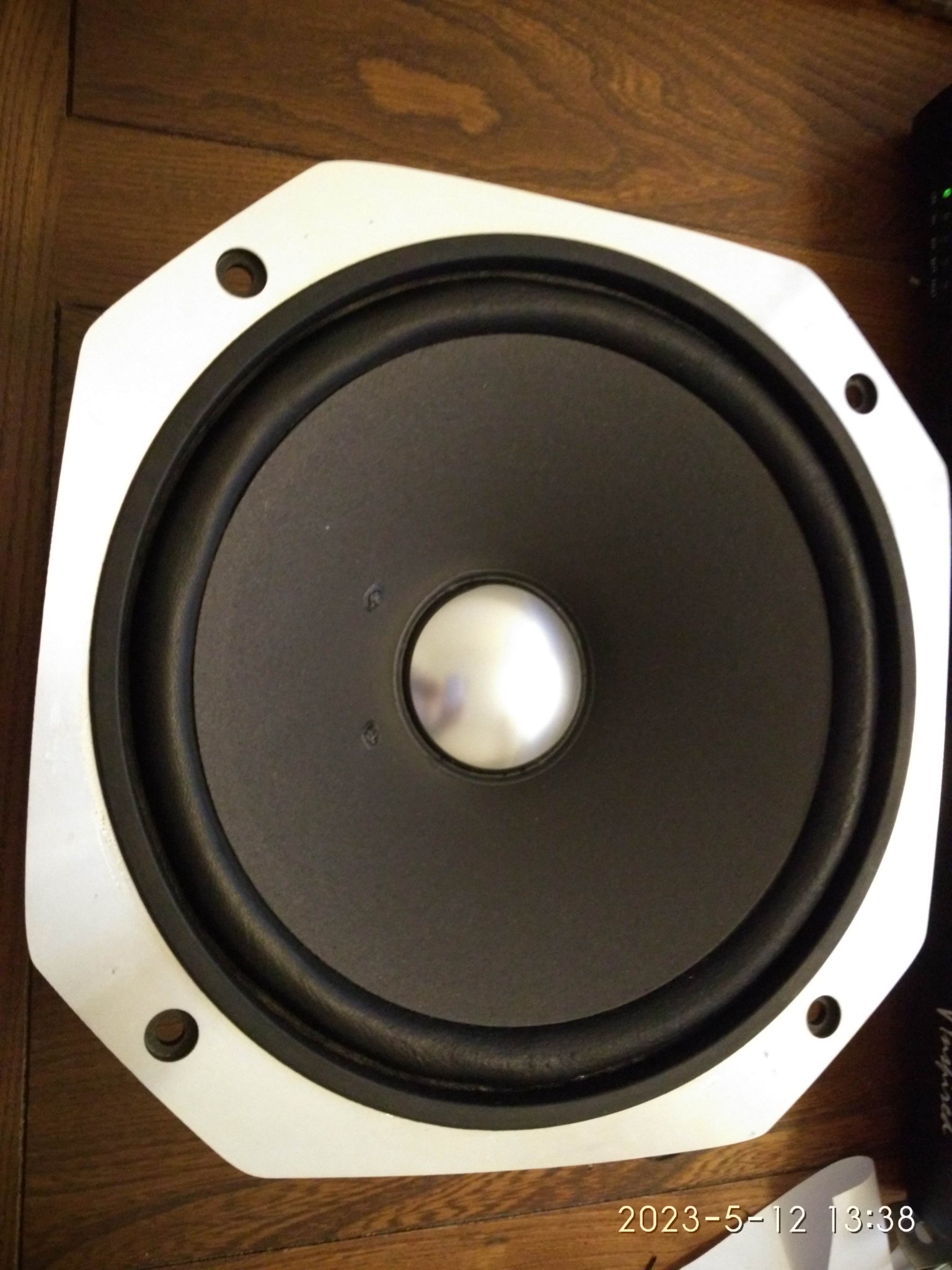

Here is the leather version installed; it was formed from a single piece:

That leather surround looks very nice. I would want to keep it. The Fs might drop some after some use. Like a leather shoe, they may soften quite a lot. Anyways, play them. If they sound good, who cares about some arbitrary number anyhow.
Too late for that, I was a little concerned that the glue would get harder with time, so i've already removed them. I might make some more as I've got enough leather.

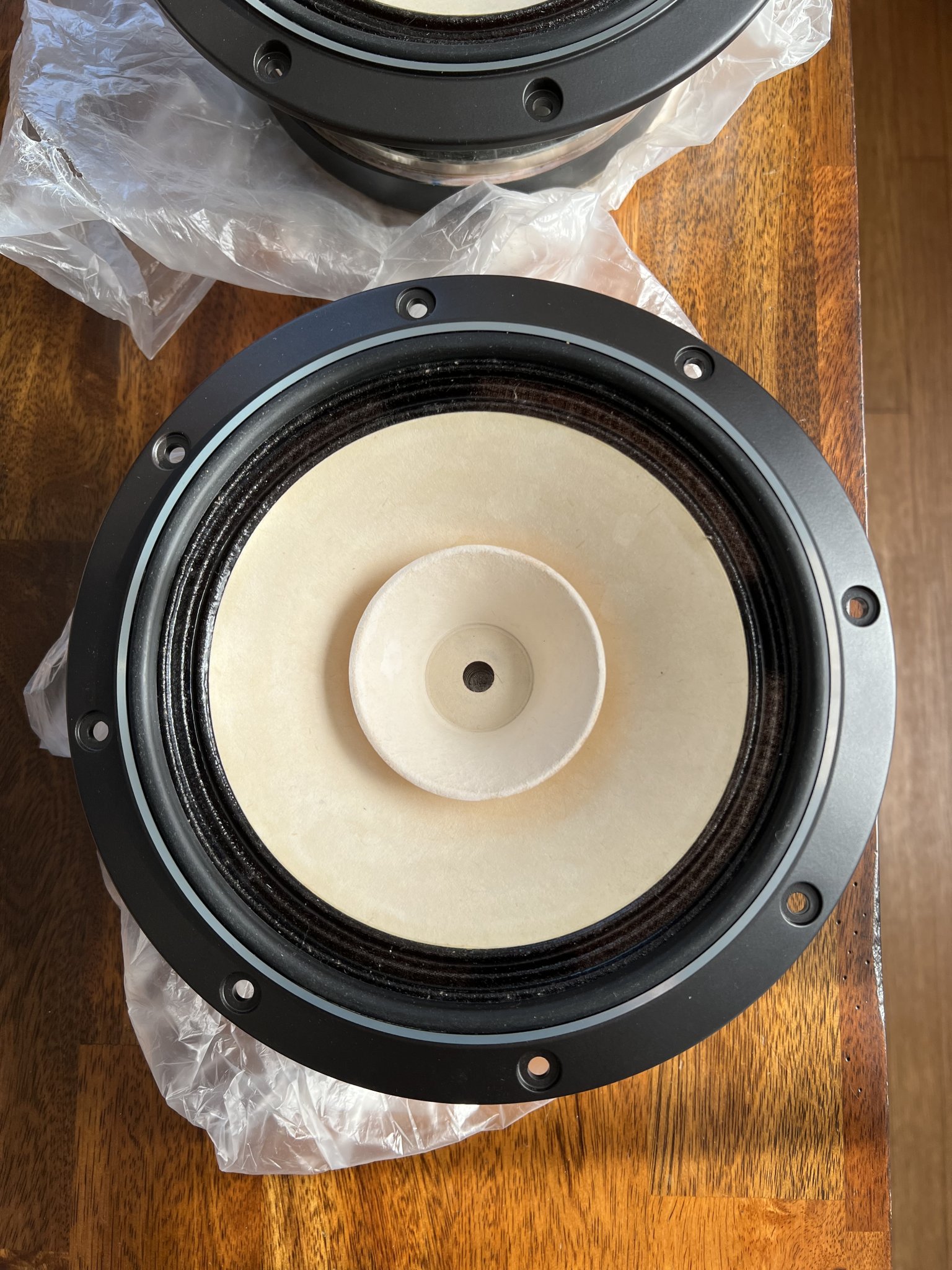

Fostex 206ES-R use a doped cloth accordion style surround as well. (Pic)
I wiuld think that might be a good solution fir your drivers.

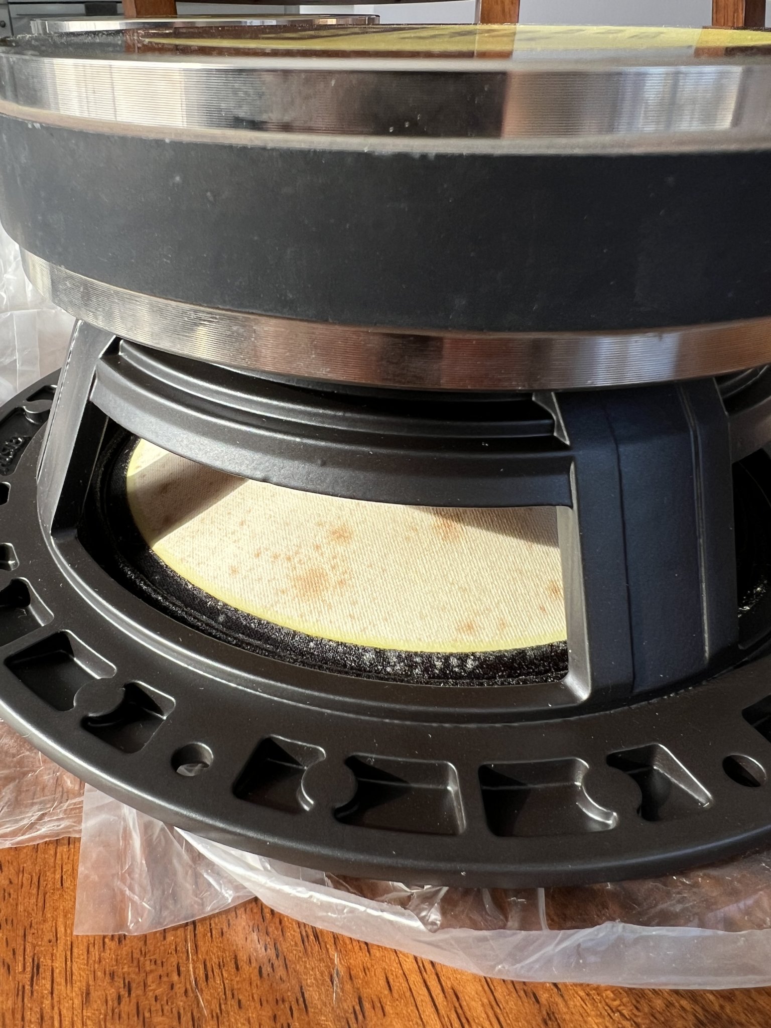

I bought what was supposed to be a NOS pair of the ES-R.
No real issues with the surrounds, but there is mildew and mold on the back of them and the cones that show through in some spots.
Only managed to get half my money back and the seller didn’t want to pay for return shipping…so I guess I’m stuck with them.
Haven’t had the motivation or time to see if anything can be done to restore them.
I had wondered if it was possible to recone them.
