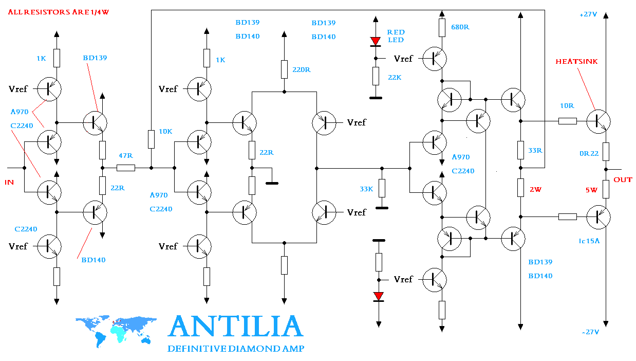

This project is my best product
hope Ulike🙂
Excellent, I'm starting designing a PCB right away
wazzat in the middle, some sort of folded cascode?
and where do your arrows go to?
it is unusual, can't say I've seen anything quite the same overall.

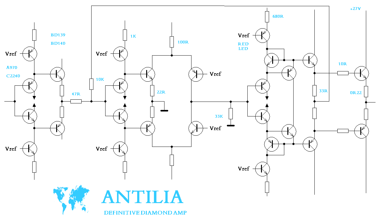

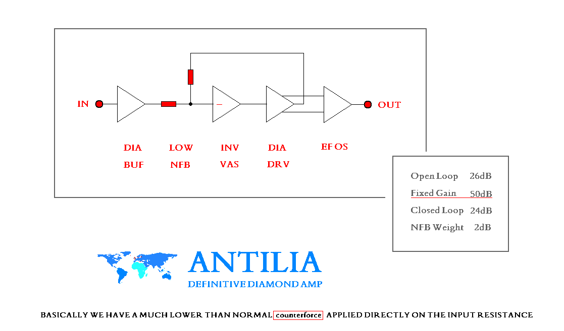

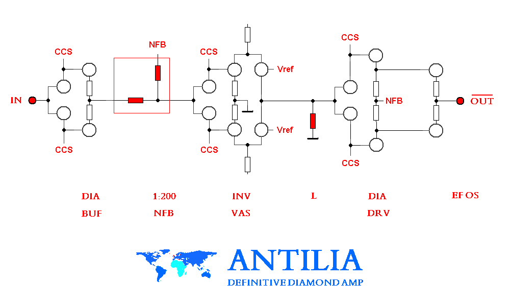

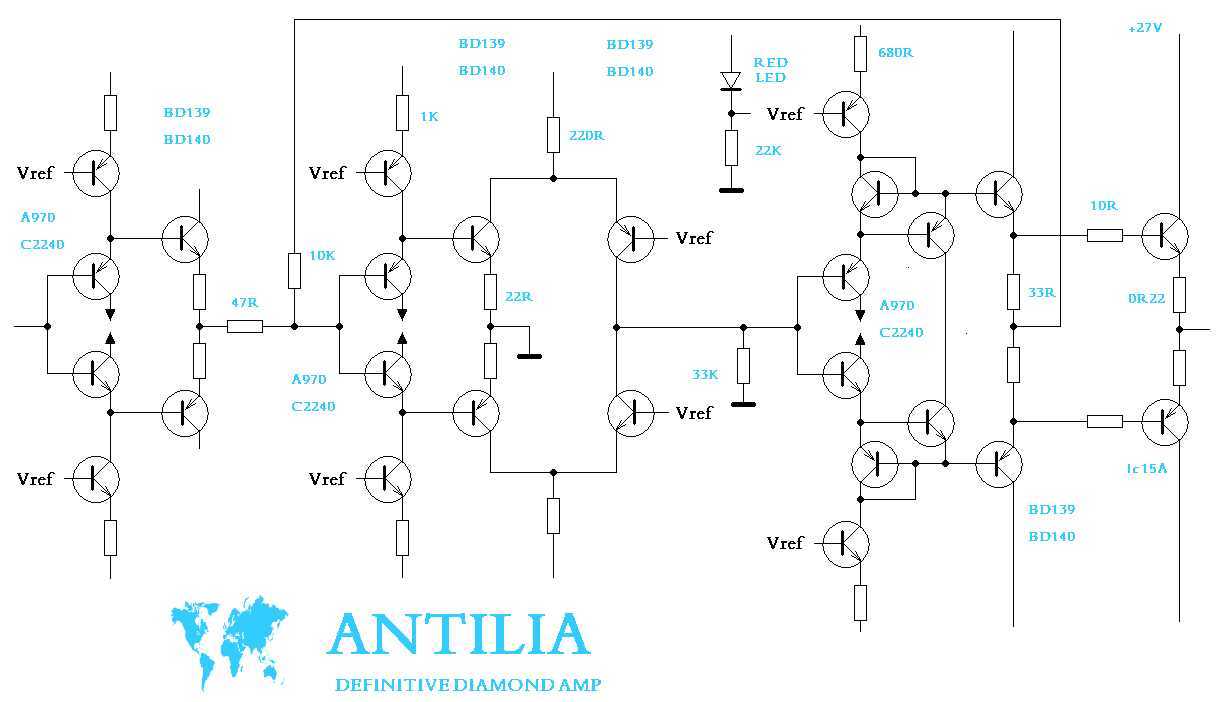

in the middle there is a diamond buffer as driver for inverting VAS
so the arrows goes in supply voltage +/- 27V

.... This is irony, SteeExcellent, I'm starting designing a PCB right away.
For credibility, you need to complete the electronic design and demonstrate that it works acceptably before anyone else can verify or rework it.
No labels makes it hard to discuss.
The transistors in the *center* of the drawing?
The top takes a 100R resistor??
