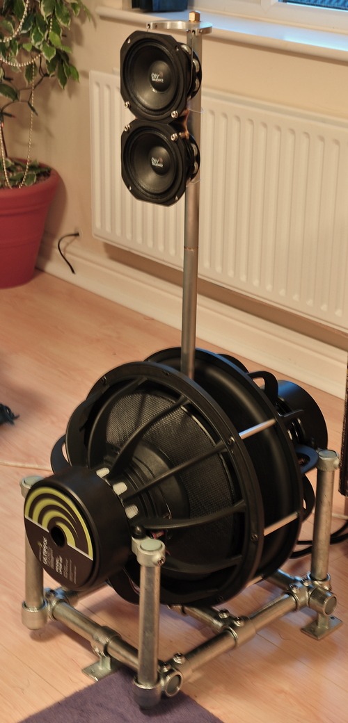

Has anyone tried to replicate the Antony Gallo baffle-less woofer?
https://6moons.com/audioreviews/gallo5/ref31.html
I like its simplicity in design and it seems a aestetially good companion for the Blanda-Gronsaker speaker Dave designed for me.
Thanks anyone,
Roberto

norman bates said:hardly any box, would need substancial eq, and thusly distortion.
probably 10-15db of boost down to 30hz.
but 4x10's with healthy looking xmax surround.
Thanks for the reply.
I've found this thread about similar approaches: https://www.lencoheaven.net/forum/index.php?topic=31371.15
but I would avoid the rod in between the two woofers.
I haven't read the review. It seems that there are two woofers mounted in the cylinder? if they move in the same direction we have the compound dipole, discussed here https://www.diyaudio.com/community/...baffleless-full-range-speakers.374043/page-10
If not, it is a sealed enclosure?
