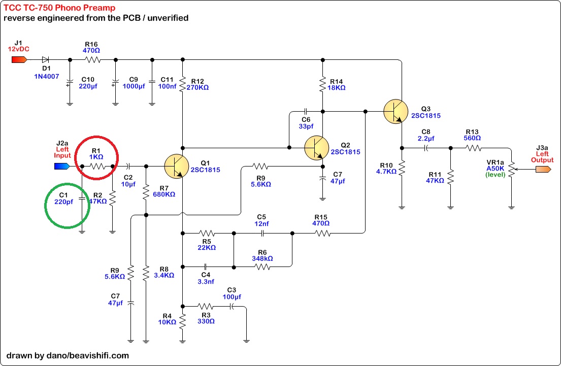

I've been playing with a TC-750 preamp.
I found this guide on modding it: https://www.superbestaudiofriends.org/index.php?threads/tc-750-phono-pre-amp-continued.150/
I've removed the 220pf input caps (circled in green in my included schematic), as I don't need any additional capacitance, I rely on whatever is provided by my cabling. I do have a couple of test records with pink noise, and I can confirm my response is very flat (+/- 1db) out to the limits of the album and my ADC (typically 20k).
In one of the comments, someone mentioned they removed the 1k input resistors (circled in red). I had tried this but thought I was getting more noise. As it turns out, my noise may have been induced by power/cabling issues. But, I did put them back in.
My Q before I try removing them again is, does anyone know what function they may provide, and whether removing them is indeed something that may reduce noise?

NOTE that C7 and R9 are on there TWICE. It may work but is probably an error.
Follow the bias path. From C2 E it runs to C7, then R7 to C2, then out to the cartridge. Two low-pass filters inside a NFB loop is marginally stable. Especially at high gain. Which is what we need here. The typical symptom is a huge subsonic peak, like 13dB at 0.5Hz. Which reacts badly with LP warp.
R1 damps the resonance some. Damping is also provided by cart resistance and general gain. I have used 4.7k there to soothe an unhappy preamp. (I have also tried insane values for C7, also series resistors there, without conclusion, ended up at 2*6,800uFd.)
