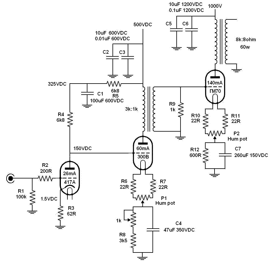

Here is my design of a gm70 amp that i have been dreaming of building for some time now. I looked around at other gm70's circuit but none of them had everything i liked so i used them as starting point and designed my own. I welcome your thoughts, comment, suggestions and criticism.
