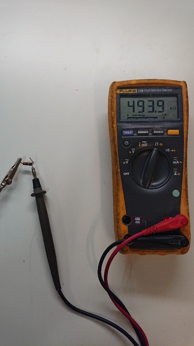

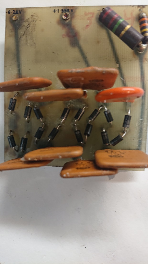

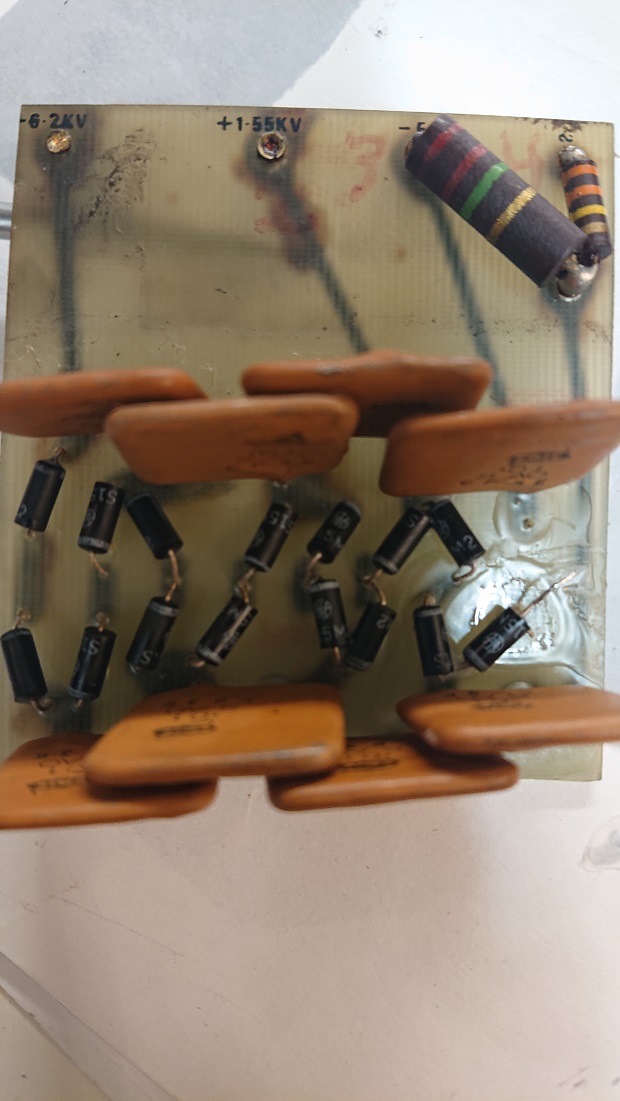

This is what the 330K resistors measure at the EHT boards. Will be replaced together with the 2,2M ones..
I was a little worried sins the board measured non equal after replacing diodes. This is probably the reason.

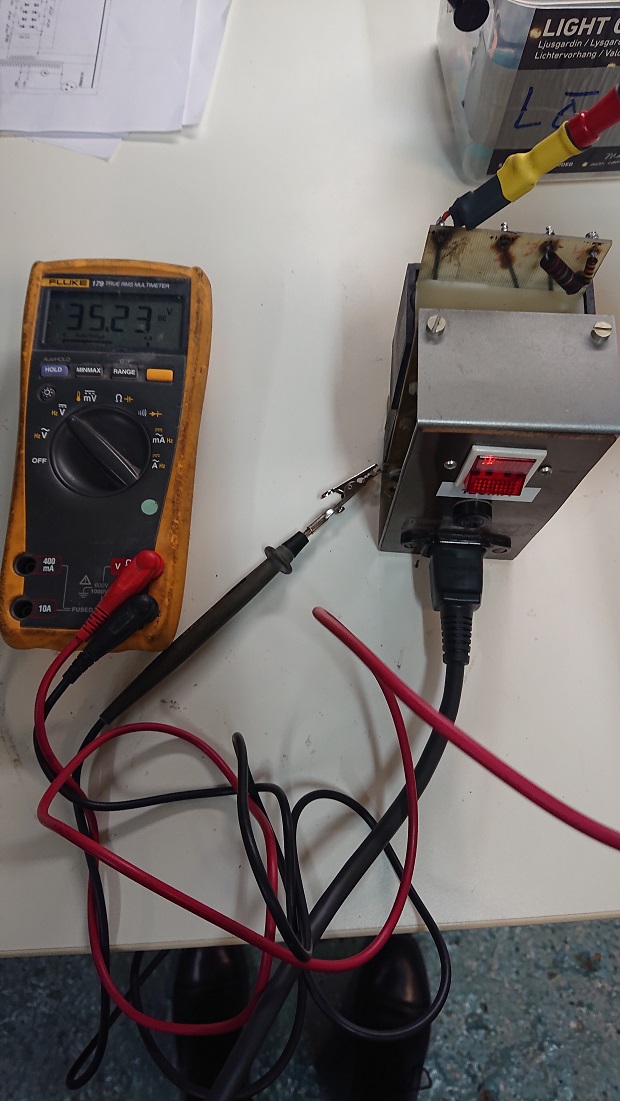

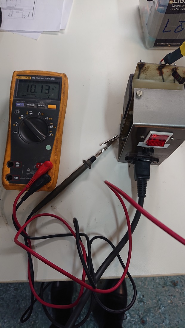

Refurbish power supply units mesured with 3*500Mohm serial = 1500Mohm together with Fluke 179 internal 10Mohm gives around 10V at at 1,5KV tap and around 30KV at 6KV tap.
This makes 10*(1500+10)/10=1500V and 35*(1500+10)/10=5285V ?
Good enough in that case.
Thanks Fabien you are right. I had some bad resistors at the EHT-board and I changed them and now the boards measures the same. 10 and 35Volts with 150Mohm + 10Mohm gives around 10V at 1,5Kv tap and around 35V at the 6KV tap. And due to load it dosent measure 40V at the 6KV tap.
All ok now

With load, I can measure up to 5.6kV in max position:

I tried to do some measurments too and got some bad resolts on both of EHT
6000v
used 20Mohm1% build in, for test I use: 1000Mohm5% :: 20Mohm1%
its somethin like 1040::20 == 52::1
1500v
used 40Mohm1% build in, for test I use: 1000Mohm5% :: 20Mohm1%
its somethin like 1060::20 == 53::1
resived voltages:
6000v is 31.4 *51= 1600v
1500v is 8.6v *52=450v
got some voltages of 1600v and 450v
why ?
6000v
1500v
resived voltages:
why ?
*my mistake, using divider of 1G::20M on 20M without calculate the internal resistance of the voltmetter
I searched a lot and do not find another solution
*the measurment is in Mohms
its means that I measure the 20||10Mohm==6.67Mohm
so on the formulla I have to replace the 20Mohm with 6.67Mohm so the resolts will X3 highger.
so it means that they ok

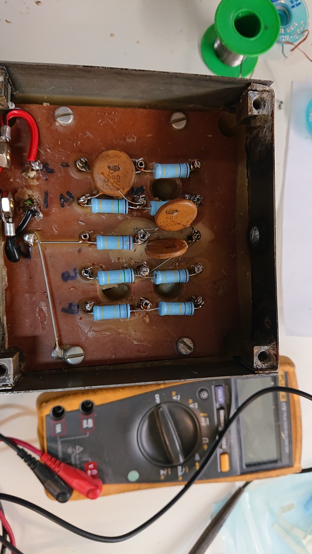

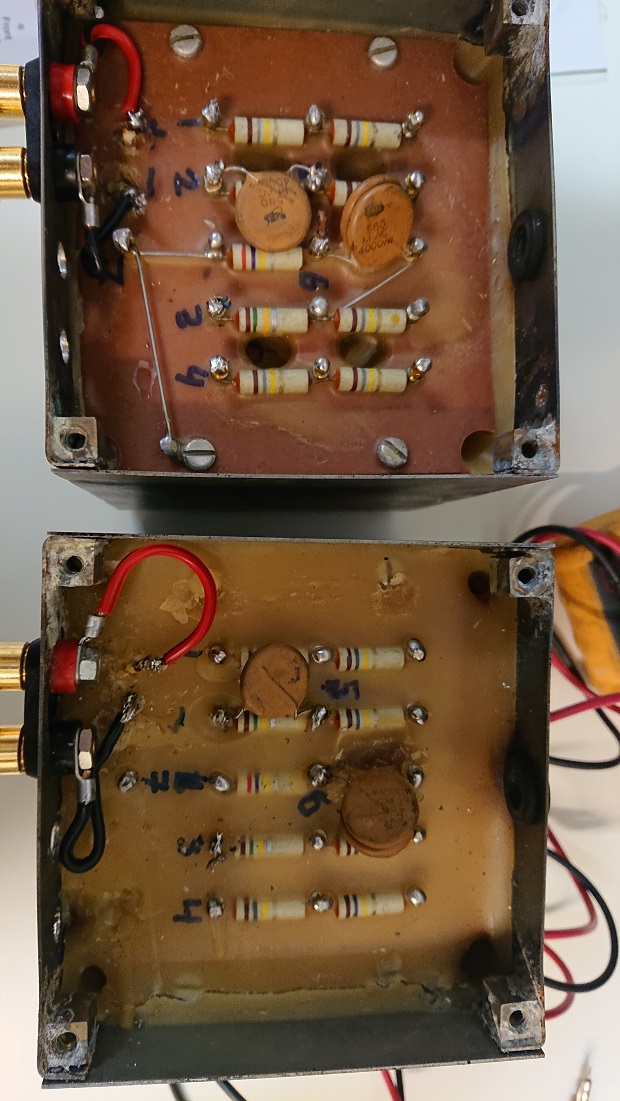

I have done some new things. Replaced the resistors at the audio transformer. They were out of spec. Measured higher values all of them.
I go with the old caps sins they seems to be fine.
