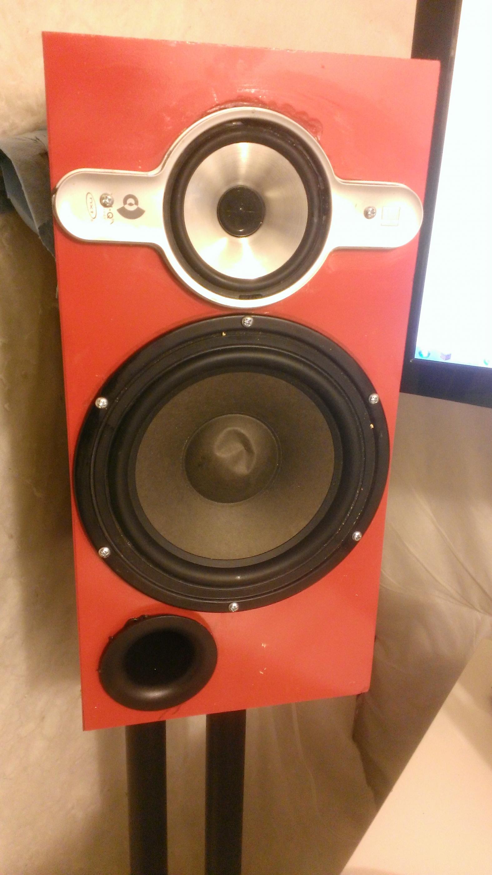

Bought these ,TIBO Edge 200 for the bedroom as there so cheap and could seem to get any used floor standers locally. Mainly listened to by my partner.I do my listening in my cellar studio on diy monitors.
So what do you get for £70 including shipping?
Of coarse ill have to peak and maybe tweak.

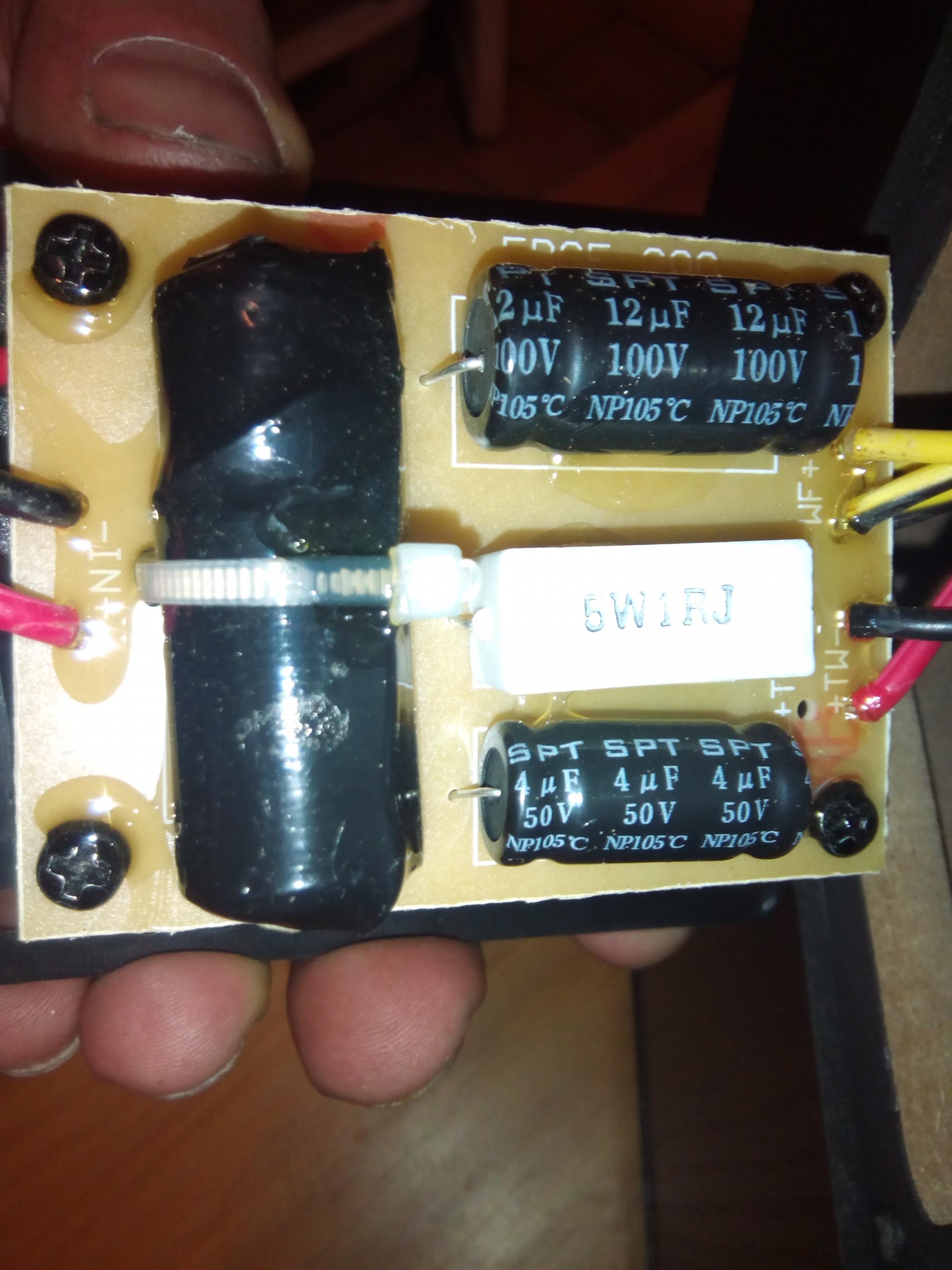

Anyone care to guess whats inside?
Is there even a crossover?

now you should try to put the coaxial on the double woofers![]()
Thanks but im not not messing with these puppies! just need a mini dsp ,currently running on 2 way car active crossover.
the coax have a serious hf rise!
The only thing you can do with those is to use one woofer only and cut them in half.
Or, first remove a woofer and search for the crossover inside.
Not much to do.
Chipboard should be doubled in thickness - that could be a nice re-use: cut them in half and double the panels

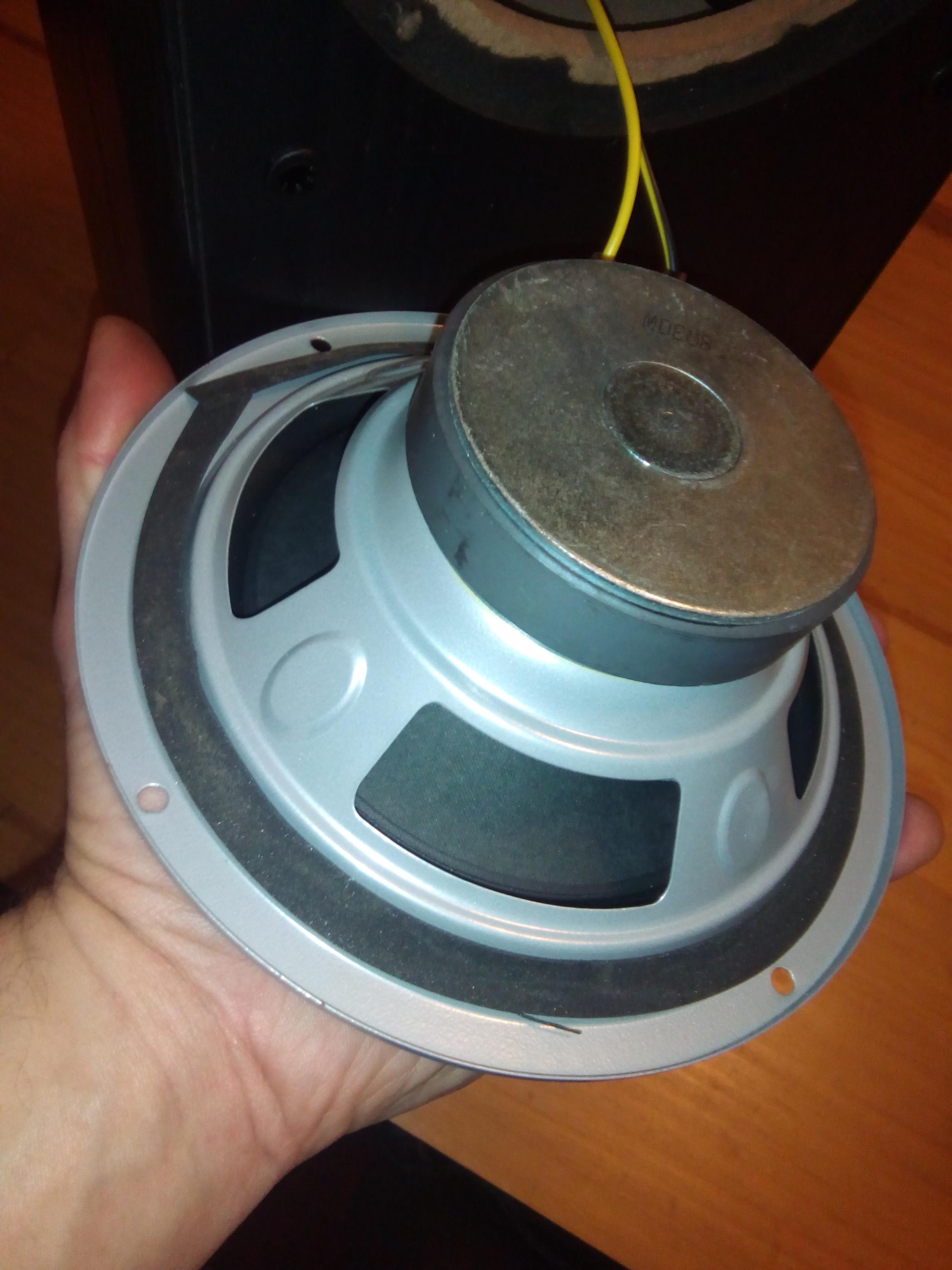

It looks like a woofer from the Fifties
Sometimes it seems to me that instead of doubling the coil value, some prefers to double the woofer !
Academically, you could revert the two woofers into one unit: isobaric load
Not quite nice to perform since one woofer is hidden....and removable panels aren't a good thing. ( there's the possibility of mounting them "kissing" but you lose the mid frequencies )

Yes, fill the whole box with a damping material. Then, if it is a vented box design, squeeze a handful of damping material and put it inside the vent.playing the seventies album rely highlights deficienies, The seventies preferred electric bass sounds more like a double bass!
lack of damping?
I was given a similar design pair of recent Sansuis not long ago; Long story short - the box is too small for the woofers, It performs better with only one woofer, the crossover was a waste of time, the driver connected without the xover performed well as a full ranger, but the high Q means there's still a mid-bass hump. I'll post pics if you want, but don't want to hijack your thread.
Starting point - measure the TSPs of a woofer & sim to see how well it matches the box/tuning
