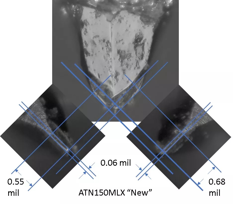

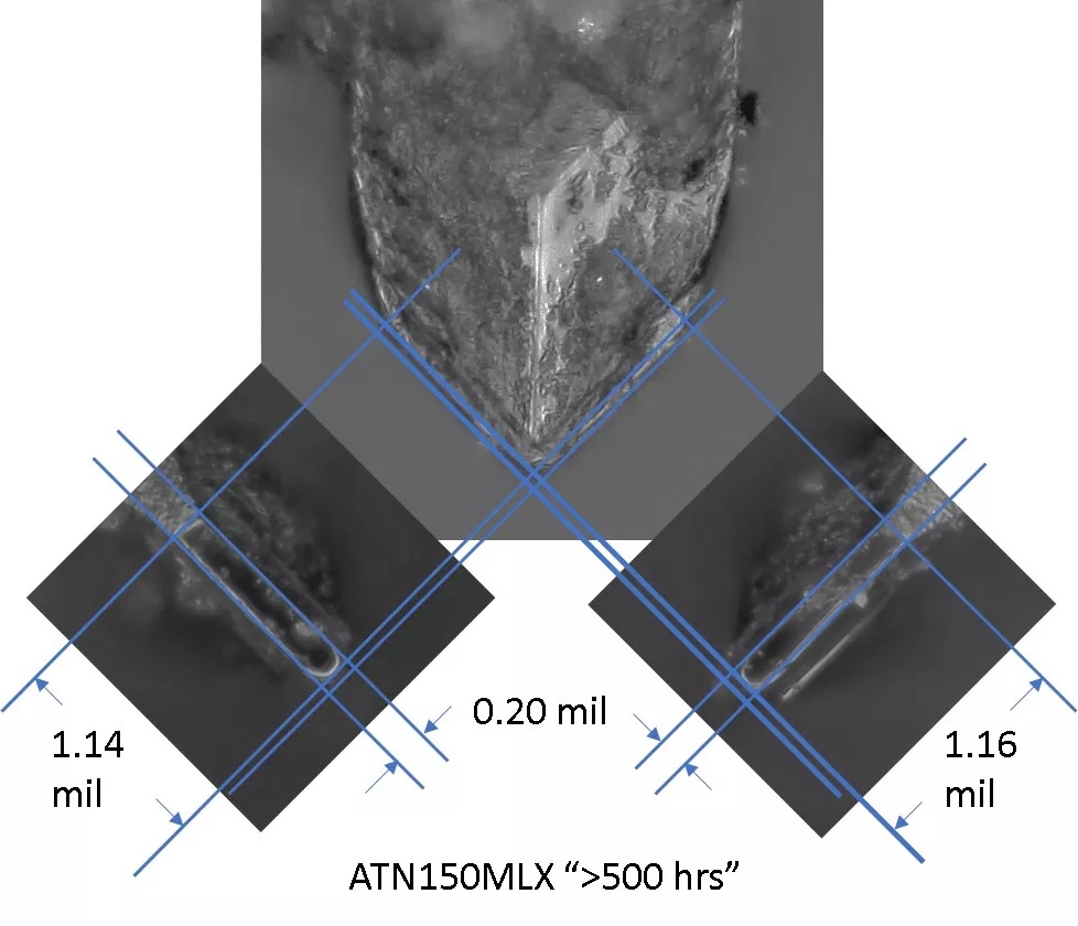

Recently I had a couple of stylii send off to be imaged as a favour. Both AT microlines, but one well worn (audibly so) and the other under 10 hours. After sticking them under the microscope a track was recorded with each so there is a record of what a worn out stylus sounds like. But we were mulling what sort of audio analysis might be useful. If I can work out how to operate dropbox I'll post links here but in the meantime any ideas what might be of use?

Note even when worn to the point of touching the groove bottom the contact patch is still only .2mil wide. HF should not be affected (for a given value of should).

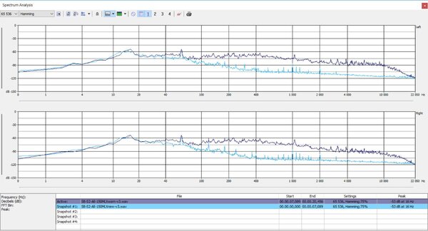

Comparisons someone has done already on the music section does suggest a very increased noise level, whereas the lead in grooves overlap almost perfectly. This I think is a sign of the stylus bottom out on modulated grooves.

Interesting. Even via laptop speakers the noise increase with the worn one is quite obvious but also the treble curiously seems more muted and a bit phasey almost. Not as incisive.
That's a bit of a contradiction, more noise and less treble, but it's how it sounds to me. The noise isn't just the background groove noise but background 'hiss' such as it is. That sounds higher with the worn yet the treble on the instruments more muted.

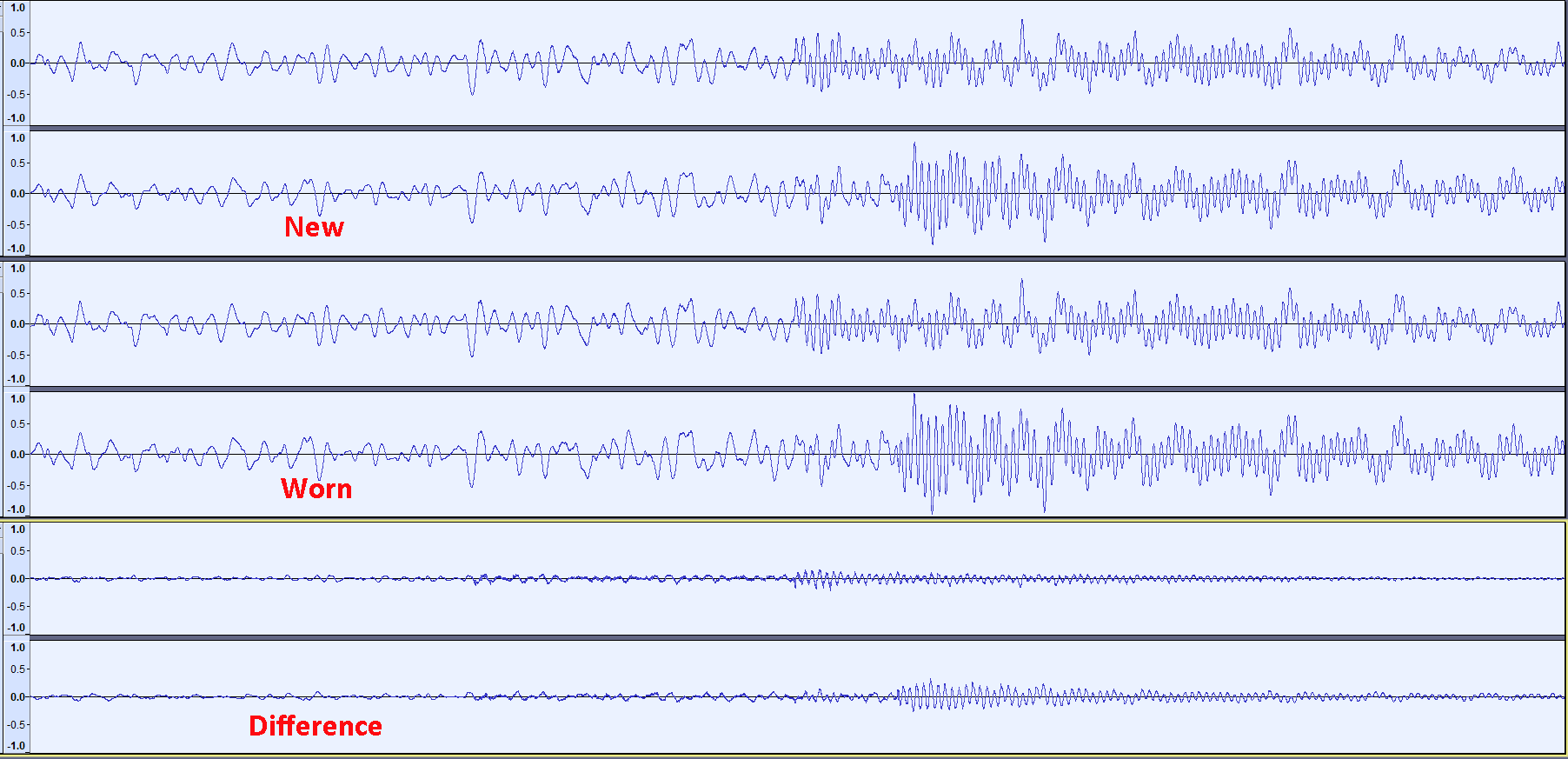

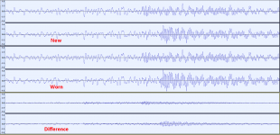

I failed to find differences in noise spectra between new and worn, but I took a 200msec fragment of a loud passage at 3/4 of the recording and time aligned new and worn as best as I could.
Then I took the difference of both, see image below.
Longer periods are not possible because of speed fluctuations of the TT.
The largest differences can be seen in the higher frequencies.

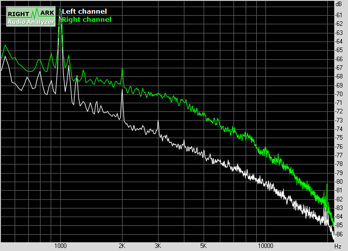

If you would have a recording of a test record with a 1Khz tone, it will be much easier to to see what the worn needle is doing to noise and distortion.

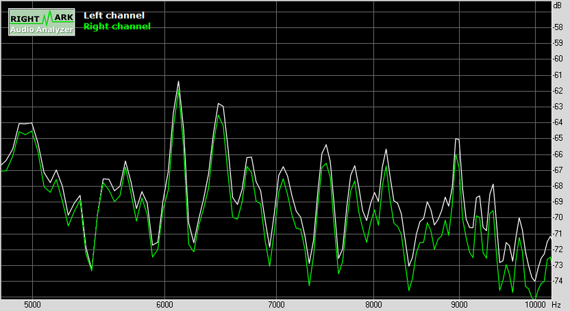

This is the music frequency response of the 2 stylii. New is left (white) and worn is right (green) This is just the music section. Frequencies not shown are virtually identical.
GRAPH 1
This is the frequency response of quiet groove amplified 26 dB. Again new is left, worn is right.
GRAPH 2
As far as I can hear and see, the new stylus has slightly better channel balance, better top end response and lower noise in the ear's sensitive range.
Otherwise very similar.
