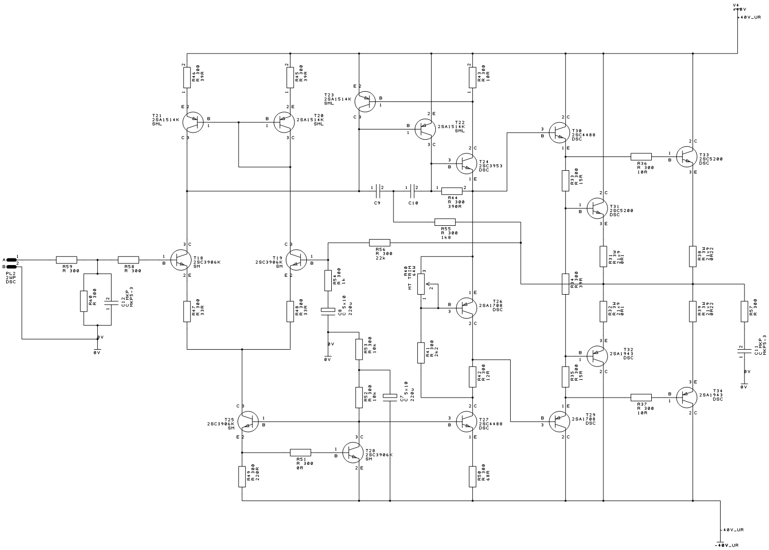

As the topic of Class-AC output sparked my interest in the VAS transistor thread, I did some cursory searching and now I'm pretty much sold on the idea.
I did note that much of the information regarding the underlapped AB version of the 'AC' idea was slewed towards using tubes; though this is not really what I wanted to do.
A question that's popped up for me is how can I determine the reactive power levels that the outputs will experience in loaded conditions? It's a little bit different to your typical equal-current multiple OPS stage, as the transistors take different amounts of loading.
I can analyse it easy enough in DC but that doesn't tell me much about what sort of reactive SOA I need to bargain in for either the power pair or the booster pair of transistors.
A second question would be what sort of thermal compensation regime would you employ? The way I see it, as long as you keep the power pair under thermal stability then the boosters will stay in check with it. Obviously placement of the transistors will also take a part in determining the overall thermal transient response, too.
(Note 2SA1708/C4488 shown as drivers - these are much too undersized for the EF-mod ops shown here, my practical choice would be 2SB1167/2SD1724)

Not that I could help with those somewhat unique problems, the typeface of components is way too small on your schematic to resolve even on my 22" monitor. This is likely going to "disinterest" potential help.
One suggestion...What appears to be an output inclusive feedback connection to the compensation network won't make the task of finding optimum thermal compensation conditions easy, as Mr Self explains. (Linear Audio #0)
So maybe leave out the bells and whistles until a basic, single pole design is functional?

Thanks; I have attached here some alternative copies for viewing.Hi
Well I am still only playing around with SPICE at the moment, but leaving it out in practice for analysis is no issue. I'll have to get myself a copy to look at.One suggestion...What appears to be an output inclusive feedback connection to the compensation network won't make the task of finding optimum thermal compensation conditions easy, as Mr Self explains. (Linear Audio #0)
Thanks, the thumbnail is fine. I should have said Self was explaining his new compensation scheme; not much more help for you there, though the article is a great write-up to enthuse over!

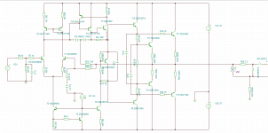

Perhaps a better approach maybe to take the path described by Broskie, here: CCDA & Class-AC
The figure labeled "Class AC IMC" is currently the direction I'm looking at.

Interesting reference, Broskie's SS class AC. Thanks Bigun. I note he's suggesting Thermaltraks to resolve the thermal compensation issues. I guess that's a reasonable move when the option of designing a fancy integrator control system is not going to be real attractive at prototype level.

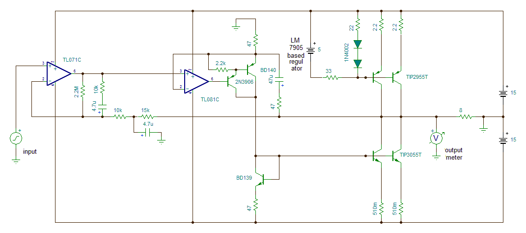

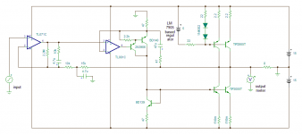

Hello folks,
I also found the class-AC interessting. So I build a small Mosfet-Amplifire with a compound stage.
I called him Bemos
The driver have a quiescent current round about 5mA, the Mosfets are not working. They switch on when the driver 20mA loads. And the driver stop at 20mA, the current does not increase. The rest of the current will assume the Mosfets.
This is a simulation with TL-Spice:
It shows the diffent currents and the takeover.
And this is the schematic:
This circuit works and it is very stabil. There are no oscillation. I tested a 1uF condensator parallel to 8ohm and Bemos do not oscillat.
Actually I want to build a class-B amplifire(Bemos), but on closer examination, it is a class-ABC circuit.
What do you think?

Looks very nice moschfet !
I would be interested to know how well it would work if you allowed more current from the Class A regime, for a Class AC amplifier I'd be wanting to see the switch-over to Class C at a much higher level than 20mA - that's more like Class AB in my books. Not sure if you have enough heatsinking to allow a switchover at 500mA for example which may get us close to 1W into 8Ohm ?
Hi Bigun,
500mA is much to much for this topologie. My experiments with 50mA was to high for the driverstage. It become to hot without a heatsink.
