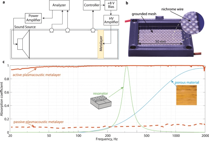

The noise reduction relies on a Townsend discharge which can be sustained only over a limited range of electric field intensity and gas pressure.
In the paper, the distance between the electrodes (nichrome wire and and grounded mesh) in the "Metalayer" is 6 mm and the voltage between them is 8 kV.
This results in an electric field intensity (E= V/d) of (8,000/0.006) = 1.3 MV/m (megavolts per metre).

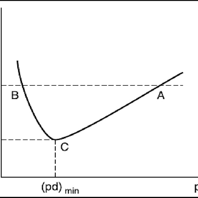

According to Paschen's law, at a constant pressure the voltage needed to cause an arc reduces as the gap size is reduced but only to a point. As the gap is reduced further, the voltage required to cause an arc begins to rise and again exceed its original value.
For air at standard temperature and pressure (STP), the voltage needed to arc a 1 metre gap is about 3.4 MV. This corresponds to an electric field intensity of 3.4 MV/m.

The field doesn't need to encompass the whole volume to be silenced. The 6mm thick grid array acts as a much more massive virtual wall. A thickness of lambda/1000 is sufficient.For air at standard temperature and pressure (STP), the voltage needed to arc a 1 metre gap is about 3.4 MV. This corresponds to an electric field intensity of 3.4 MV/m.
This doesn't mean that the scheme is actually practical (ozone, etc), but it is an interesting development anyway
