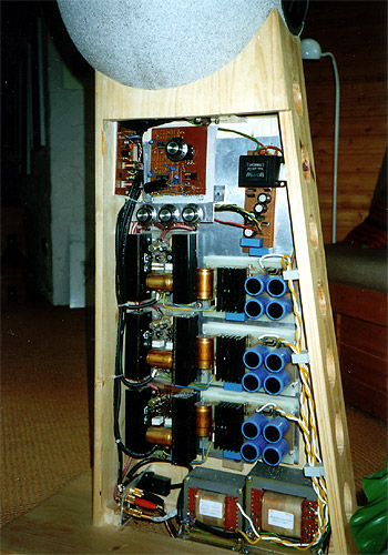

This is another "stone age amp with single-voltage supply and output capacitor":
http://www.geocities.com/quhno/black-devil/
I heard it in a fully active Manger system and it was tonally much better than most "modern" solid state amps. After tuning it with a ton of mica it was even able to fully exploit the impulse response capabilities of the Manger.
